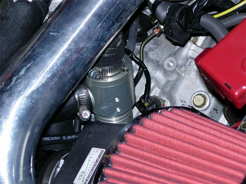

i get the same flutering sound only when i boost a little over vacuum and drop it. ON wot i dont get it. I just installed my not long a go and didnt adjust the bolt at the top...do i need too? Here is a pic of mine..as you can see bov is hooked up on the IC pipe
