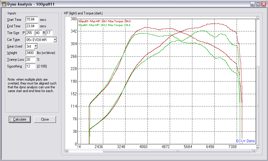

Do an overlay between the two logs in ECU+ so we can really see the difference in the two graphs. Use the power of the ECU+.
You also might want to turn on some more smoothing. Your peak numbers will come down but it will be easier to see the difference in the cruves.
Like this:

you have 20% loss in the calculation. That is NOT WHP, that is approx power to the crank. Just FYI ... Its still 30hp before and after though so thats good.
Old Jan 22, 2006 | 08:55 PM
4TUN8's Avatar
Joined: Jan 2005
Posts: 2,458
Really? Explain to me why before I touched anything I put down about 330hp, and I had just dyno'd 320?
How sure are you?
Old Jan 22, 2006 | 09:08 PM
4TUN8's Avatar
Joined: Jan 2005
Posts: 2,458
http://www.ecuplus.com/forums/viewtopic.php?t=255
Looks like WHP to me....

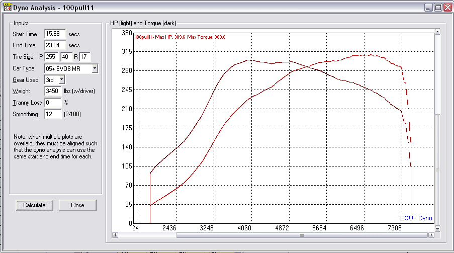

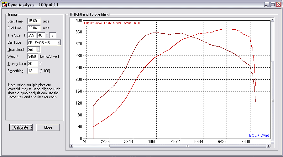

Originally Posted by 4TUN8
That's my graph/thread and that graph is with it set at 0% tranny loss, not 20%.
The graph above in this thread I set at 20% to match your graphs.
Every ecu+ dyno log set at 0% tranny loss that I have done on the dyno is almost spot on with the wheel tq the MD dyno reads and within about 10 wheel hp the MD dyno reads. With it set at 20% loss the numbers are MUCH higher, at least this what I have seen on mustang dynos.
Here I can show you:
Here is my actual dyno graph from the MD dyno (look at the higher number test run which was my 100octane tune):
and here is the ECU plus log (the actual log from the dyno pull) with it set at 20% tranny loss:
and here is the ECU plus log (the actual log from the dyno pull) with it set at 0% tranny loss:
