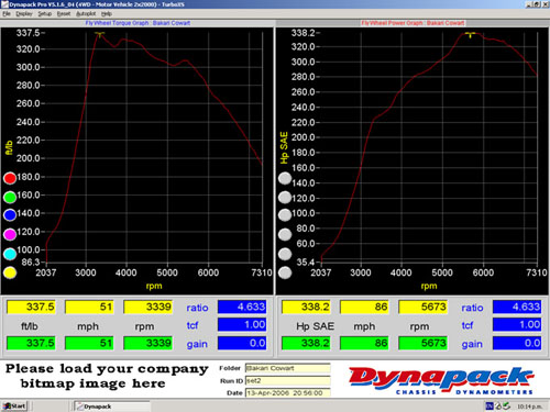

Just got back from getting tuned at TurboXS and they are a pretty good group of guys. Germain was very helpful in answering all of my questions and explained everything.
Now for the numbers! I went very conservative with the stock turbo and only ran a max of 21psi with conservative timing. The car pulls like a bat out of hell and feels great. I can't wait to get to play with it a bit more but I got stuck in traffic on 95S at 10:30PM
Everything was done on straight 93 pump.
Let me know what you think.

Now for some info about the session:
The stock injectors were left in to see just how they would perform with a stroker. The result, NOT GOOD!!! I ran out of injector at 308hp and my duty cylcles were at 90%+
After seeing that I immediately pulled the car off the dyno and swaped in the 780cc injectors and I had duty cycles in the 50-60% range. No IDC were over 62%.
Timing was very conservative the whole time and never added more then 6* on the maps. We did have to pull a ton of fuel on the trim maps to keep the 780s under control. Knock was virtually non-existant the entire time which made me very happy. I now have a very safe tune (run daily on map 2) and a whole host of more aggressive maps that I won't be running daily.
