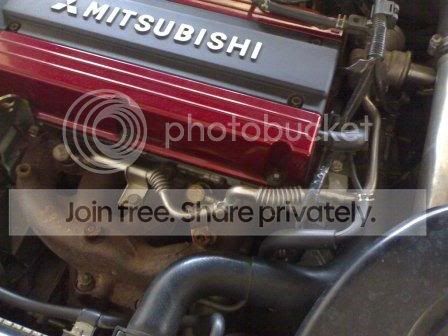

so, hold on a minute here, do I have this anti-lag thing or not? Seems from what triny dex is talking about, it's going something like it but not quite.

yippee!!! I have anti lag. All I need now is a clue!!
I'll post a pic of the manifold proper once I get it done (in about 10 minutes).

Anyway, this job is taking the ****. We're up to drilling the M10 bolt with a 6.5mm drill cos extractors are just not having any of it. The bolt is so hard the high speed drills are having a hard time. We've been at it an hour now. Managed to ease it like 1/2 a turn just hammer drifting it.... DON'T TRY THIS AT HOME!!
Anyway, here's another pic...

The tube is the Secondary Air System, which isn't fitted to US spec cars. Here's a little about it:
This is an excert taken from the manual about secondary air control....
During deceleration from high speed, the secondary air is introduced upstream of the turbo charger. This operation prevents the turbine speed from dropping and thus enhances responsiveness when the driver next wishes to accelerate. for maximum effectiveness, secondary air is introduced into the exhaust manifold immediately down stream of each cylinder.
secondary air is introduced for approximately 3 mins when both of the following conditions are satisfied
a) The engine speed drops sharply after at least 3 seconds of full-throttle acceleration.
b)The engine speed is 4000rpm or higher
(when you're giving it some!!!!!)
There are 2 actuators
1. secondary air control solenoid valve.
This is an ON/OFF solenoid valve, it switches the pressure applied to the secondary air valve between the intake manifold vacuum pressure and the atmospheric pressure. When the solenoid coil is not energised, continuity exists between the X-nipple and the ambient air.
When the solenoid coil is energised,continuity exists between the X-nipple and Y-nipple.
2. secondary air valve....
The secondary air valve turns ON and OFF the secondary air supply by opening and closing in accordance with the vacuum pressure applied to the diaphragm chamber.
