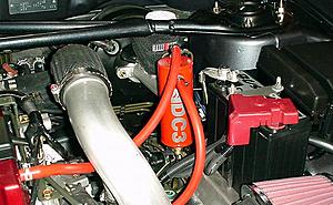

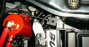

I got a chance to mount one of my cans to night. I have small battery so it was easy took me about 20 min to mount it.
