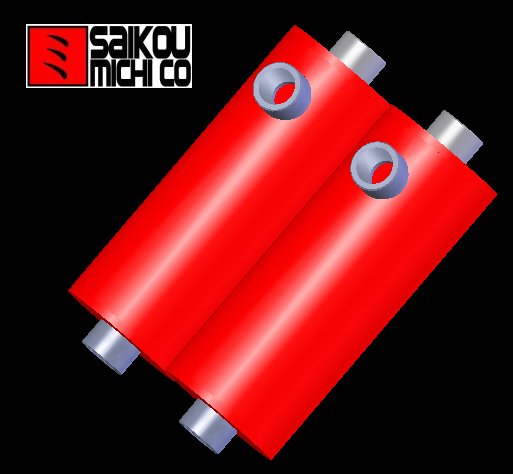

Dual chamber concept
I am toying with a 2 in 1 concept catch can design. I got a PM regarding a rectangular shaped one with separate compartments. I also tried to figure out a simpler universal version working with this idea. Here is the simplest design.
Still has a vapor snorkel, and stainless baffling material inside. No sight glass, and of course has a drain in the bottom of each section.
Both top fittings are the incoming line, and the side fittings are the exit.
Take a look
The size is compact, roughly 2" deep, 4" wide, and 5" tall, not including the fittings sticking out.

Wow, that sucker is pretty compact. Looks great though You know, you could offset the sizes, make the PCV can larger in diameter while the intake can smaller and still keep it roughly the same dimensions. Just a thought...

I can imagine making the PCV side longer for more volume. Good suggestion

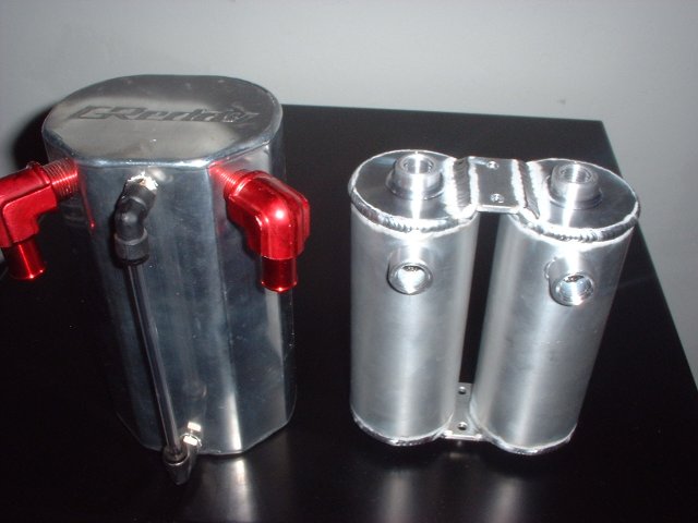

It's DONE! I am gonna try to post pics tonight. Maybe I will update my website too....
I figured I better put up a pic before I change my mind and not do it...

more pics before I got to...zzzzzzzZZZZZzzzz
Some pictures comparing the DC3 with the leading brand
...of course this is not the finished look, I wanna get them powder coated/painted
Attached Thumbnails Saikou kun catch can thread-dc3_firstshots_compare.jpg   Saikou kun catch can thread-dc3_firstshots_side.jpg   Saikou kun catch can thread-dc3_firstshots_welds.jpg
