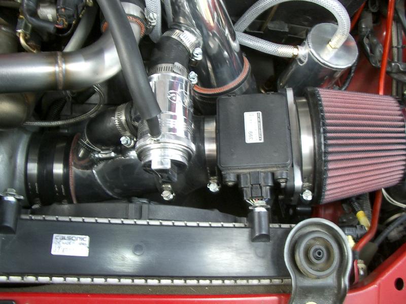

I am carefully epoxy-gluing my MAF screen to my MAF housing. Also, since this happened to me, Tuning Technologies moved my BOV-to-intake tube further away from my MAF. The AMS intake system that comes with their turbo kit leaves the BOV return tube very close to the MAF and the angle is also a little too close to 90 degrees as opposed to a more acute angle that points the dump back at the turbo....

Originally Posted by Smogrunner
Also, since this happened to me, Tuning Technologies moved my BOV-to-intake tube further away from my MAF...
After our brief PM exchange, I decided that I agreed with your assessment and asked Drifto to do exactly that in fabricating the intake setup for the GT35R. It can be seen in this photo:
https://www.evolutionm.net/forums/at...chmentid=90584
Hopefully, directly the BOV vent directly toward the compressor will prevent this situation from occurring. If not, it's on to 'Plan B'.
We'll know by Friday morning if the stock maf screen - Epoxy'd in and far from the Bov dump, will hold whp in the high 500s and wtq in the 525 range. If all goes well, I'll FINALLY be drag racing my car on Saturday.
