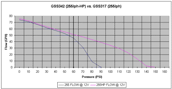

I have no reason to doubt Buschur's description, but it is useful to note that the basic difference between the Walbro 255 and the Walbro 255HP (the 342 model) is that the HP pump has much higher flow characteristics ABOVE 65 PSI, as you can see from the attached chart.
I have the Buschur Modifed pump - actually two of them - they greatly outflow the #342 walbro at high psi applications
Al, what hard data do you have that shows that the Buschur modified 342 outflows the regular 342 at boost levels up to 35 PSI, for example?
Remember, you must add your expected boost range to your base fuel pressure to find the range in which your pump must perform. For example, say your base fuel pressure is 45 PSI and you want to run 30 lbs of boost... you need to find a pump that will flow the volume of fuel your engine needs at 75 PSI. The Walbro HP drops less as pressure increases than the standard Walbro 255. The point is, the flow at the boost levels you're planning to run is the critical point, and pumps compare differently at different levels of pressure, so make sure you know what you're looking for.
Buschur's description says that that particular Walbro flows 50% more at 100 PSI than the standard 255 Walbro. That may be true, but there are two things to remember: (1) you'd have to be boosting at about 55 PSI in order to need to compare at 100 PSI , and (2) the regular Walbro drops essentially to -0- at 90 PSI (see attached chart), and so flowing 50% more at 100 PSI doesn't tell you much about the characteristics of the pump compared to anything else...
One thing is interesting -- the Walbro 255HP (the model 342) actually outflows the Denso Supra pump at very high PSI levels, although the Supra pump outflows the Walbro at levels up to about 30 pounds of boost (70-75 PSI). Of course, this is ALL somewhat dependent on the voltage supplied to the pumps...
Food for thought...
