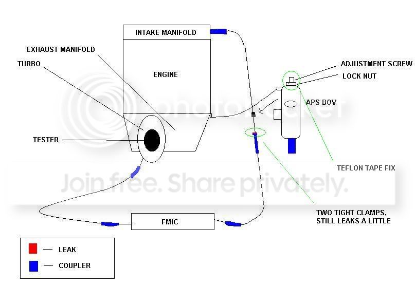

Here is a diagram of the leaks I had when we started. Excuse my freehand MS Paint drawing
Most of the leaks at the couplers could be fixed by putting the clamps a little closer to the edge of the coupler and/or making them straighter (more parallel to the coupler's edge).
As you can see, I had the same leak in my APS BOV that a few other people had. We fixed it with teflon tape around the threads.

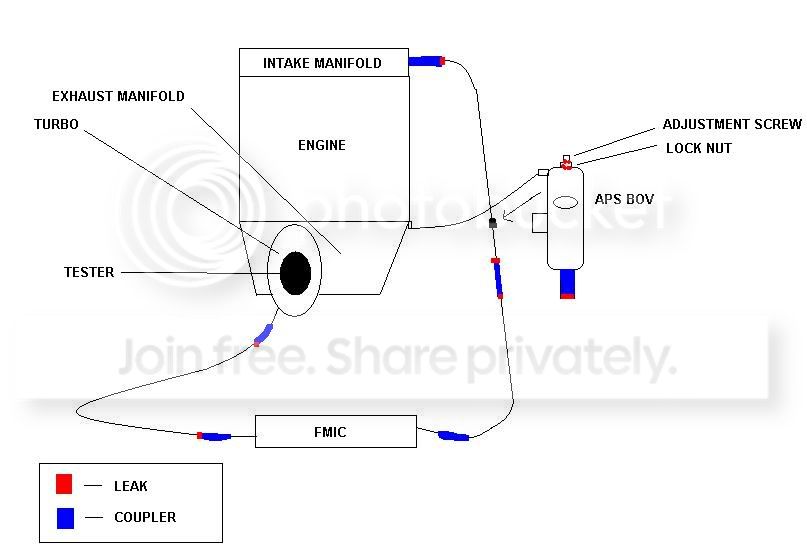

Here is the after-test pic:
As you can see, the only remaining leak is on that one coupler. There are two damn clamps on there, one t-bolt and one worm clamp, and it still leaks. It is not audible at all but if you spray soapy water on it, it will foam up on the top third of the pipe. We messed with it for a while but ended up leaving it since it was so small. We were able to make it better, just not perfect.
The only audible leak in the whole operation was at the BOV screw and the BOV-UICP clamp.
