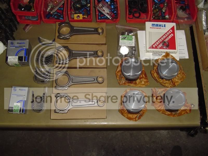

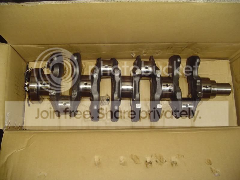

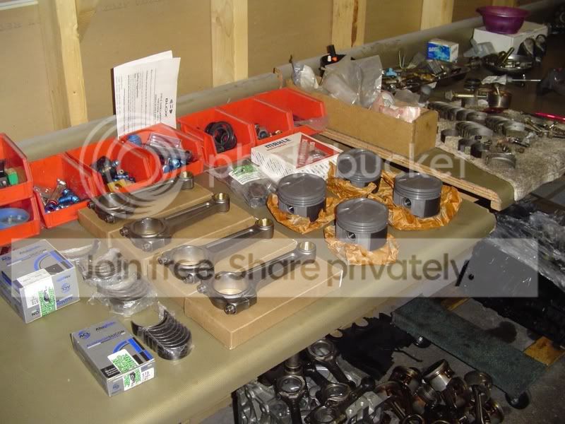

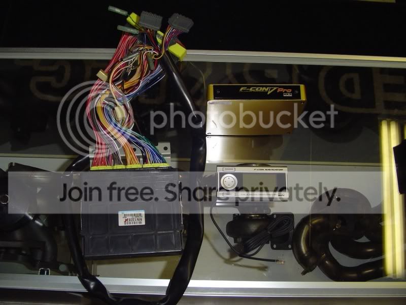

More parts came in
Got everything back from the machine shop
Brand new 2.0L mitsu crank, balanced with rotating assembly.

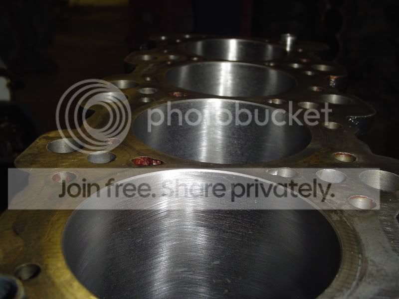

Block was hot tanked, bored .20 over, and honed.
Manley Rods and Mahle pistons from SBR. ACL coated bearings and balance shaft elimination kit from Jackson Auto Machine.

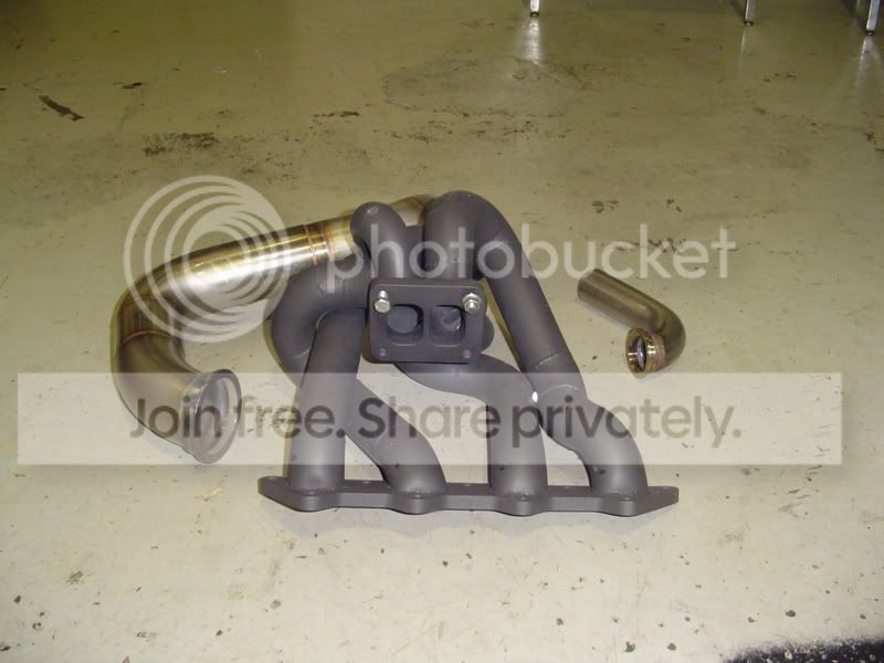

T4 divided topmount manifold, 3" downpipe, with 44mm tial wastegate dump tube.

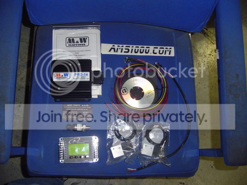

HKS F-con Vpro, Evo 8 wire harness w/stock computer, HKS F-con Navigator.
NLR AMS-1000 boost controller and M&W Pro14 Ignition Module
Things are starting to trickle in here and there. Hoping to have the motor assembled and in the car by the end of the weekend. Stay tuned.
