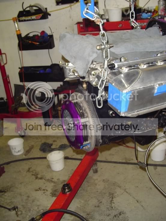

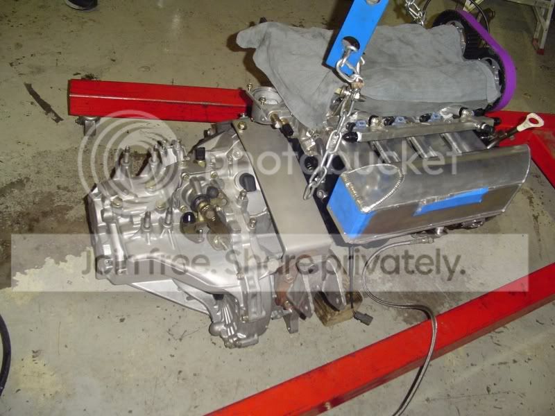

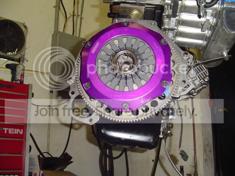

Finally got back on the car the past weekend.
Got the clutch bolted up to the motor. Triple-disc carbon Exedy w/ heavy duty pressure plate (200#'s of extra clamping force).
Next the tranny was mounted and scatter shield installed, damn shield is a PIA and I don't suggest doing it with the motor and trans in the car.

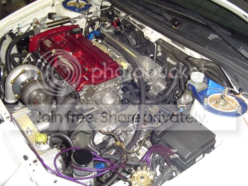

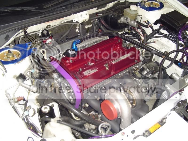

Here it is sitting in the car pretty much done and ready to go to Tim @ V&P for some fab work. Wiring harness is routed. Turbo and manifold are mounted. Intake manifold, T/B, and throttle cable are installed. Transfercase and driveshaft installed. Only items left are the axles, varous pulleys/belt, front motor mount, and plumbing the oil/water/boost lines.
The valve cover is for mock up as the other is being powder coated at the moment.

interesting how you faced your intake housing to the other side.. cant wait to see some numbers!
Old Feb 1, 2007 | 07:37 PM
  #59
EVOlunchbox's Avatar
Joined: Dec 2002
Posts: 1,183
From: Pa
What is the benifit of having the turbo the opposite direction? Will the intake be on the opposite side? How will you deal with the heat coming from the down pipe off of the turbo affecting the small radiator?
Different, I like. Good luck!
