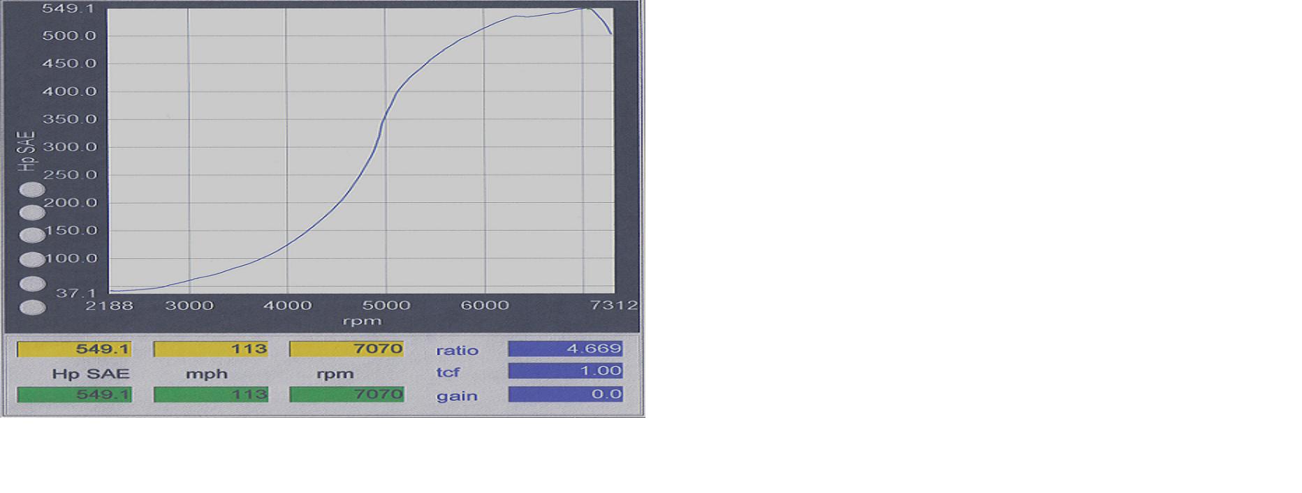

I noticed that the pumps in Ohio said "minimum 70% Ethanol" on them and the local pump down here in Indiana says "minimum 85% Ethanol".... so I am probably actually tunned on "E-70" or some "in between" mix. I will monitor my A/F ratios closely over the next few fill ups to see how the local mix works out since it is supposedly "pure" E-85 here.
Just for giggles I dynoed the car the day after the tune on a dynapack AWD dyno up in Michigan to get another comparison point between Davids Mustang dyno and the other dyno's that are out there. On the tunning factory's AWD dynapack (formerly Godspeed) I made 549 wheel HP. The curve is shaped a bit different and of course has a higher peak output. Does this mean my car is faster today than it was yesterday when I left Daves shop dyoing at 503 wheel HP? Lets not be silly! Same tune, same boost, same weather conditions... only change was the dyno being used for the testing.
On the gas milage issue, driving 80 mph with some nasty wind conditions I was getting 18 mpg highway on the E-85 on the trip home. The longest single stage of the trip was 225 miles and used aprox 12.5 gallons of fuel.
I will scan in the Dynapack dyno sheet so people can compare it to the Mustang dyno sheet.
