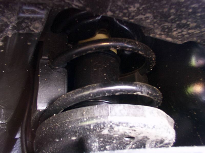

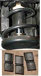

Make sure your EVO's shipping blocks are not still installed in the front struts my (censored) dealship never removed mine when they supposidly did their initial inspection on the car.

They are 6 inch pieces or solid rubber that are located on the inner side of each front strut assy. The middle of the black wraps around one coil and the block extends to the next upper and lower coil. They are suppose to be removed durring the initial inspection when your car comes off of the truck to the dealership. I ran 2100 miles on my car before noticing them still in there, i'm really mad... I should keep them and lower my car and when I do end up breaking something take the car back in with shipping blacks and tell them those where in there since i bought the car, how else would I get ahold of something like that.
I'll post a piture tonight if I still ahve the blocks

there you go, those are the SOB's
here forget the link

Got my EVO last Friday, Jeez, no wonder the ride was so bad I feel so stupid, have done *a lot* on cars for years, even put the thing up in the air to check it out, how the hell did I miss THESE???
Hope this isn't too redundant, this image really shows how they look on the car & off. Mine had 2 on the driver's side, only 1 on the passenger's.
Seems like an epidemic!
Dan

Great post, looks like mitsu isn't doing their job. Mine hade one on each spring. Rides like a new car huh...wait a min it's suppose to be a new car.
