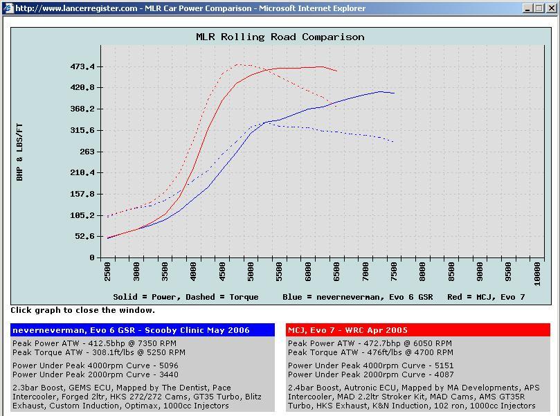

Mark,
412 was the peak ATW number from a DD of I think neverneverman's car running GT53R on Optimax on MLR Modified. Basically it was just an example of another UK car running 2+ bar boost on pump fuel. Obviously it has nothing to do with you. And for some reason Warttalon seems to think 412 ATW on a DD is flywheel numbers.
Can you tell these guys Shoot44 does not give flywheel numbers!
Here is the graph in question...

I don't think those are flywheel numbers - I never said that. 412 on a DD at 33psi is extremely weak. I know exactly how DDs read in normal mode with no correction factor - my local sponsor has one. It's all I use nowadays...

The graph in red is my pre spec engine this made 568hp and 524ftlb on the same dyno on pump fuel 97octane it also made 636hp and 568ftlb on 102octane race fuel,
This was also the same car that did the world gumball across 3 countries inc LA/Vegas 3000miles driven very hard running 2bar boost mapped on UK95octane fuel for the event,
That engine does rather well on spool also.
