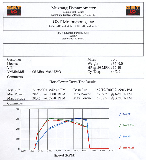

Just got home from GST after testing the ARC Induction Box. We did a pre and post dyno run and the ARC box & tune made +13 WHP and +15 WTQ. Details below...
First run back in November:
Tanabe 2.75 DP
RRE Rally Cat
Vishnu Sig exhaust
Works drop in
Hallman MBC @23psi on 91 octane
Horsepower Freaks LICP
Bryan@GST tune (razorlab) = 293whp/295WTQ (IDC= 98%)
Baseline tune today:
Tanabe 2.75 DP
RRE Rally Cat
Garage HRS exhaust
Works drop in
Walboro Fuel pump
PTE 680cc Injectors (IDC= 82%)
Bryan@GST tune (razorlab) = 290whp/288wtq (the lower #s might be due to the exhaust or the uber wide tire/wheel combo I am running)
Baseline mods + ARC Induction box = 303WHP/303WTQ
Big props to Bryan@GST for the tune and thanks to Cal@Speedelement for a great deal on the ARC induction box!!! For those of you who arn't familar with this dyno, its a uber-low-reading-heart-breaking Mustang dyno.
PICS!

Yeah intakes definitely work you just have to tune for them. More air is just that; more air. I was impressed that you hit that gain, it is quite nice and you can see the gain especially in the torque.
I just don't get why you are running larger injectors at this point in mods but that could easily effect your WHP as well.

my IDC (Injector duty cycle) was 98% before I installed injectors. Now they are 82%.

The base run was with the injectors as well, the test run was with adding the ARC box and tuning for it. He had run out of injector with his current mods as he was running 98% DC.
Just installing the box gained approx 6whp/6wtq 3 pulls after installing (let it warm up fully on the 1st and 2nd pulls). Tuning for it gained the additional power. The test run gains where 100% from the ARC box and tuning for it. No other factors.
The install of the ARC box was done on the dyno and took about 10-15mins.
