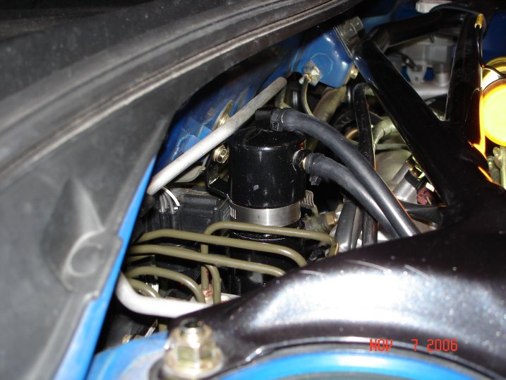

SlowCar's Avatar
Posts: 3,456
From: Kingdom of Saudi Arabia
my ghetto but effective catchcan
Old Feb 25, 2007 | 09:10 AM
  #37
honda-guy's Avatar
iTrader: (55)
Joined: May 2005
Posts: 3,589
Likes: 37
From: Central PA
almost as ghetto as mine - https://www.evolutionm.net/forums/sh...d.php?t=233671
Originally Posted by honda-guy
Old Feb 25, 2007 | 12:33 PM
  #40
4TUN8's Avatar
Joined: Jan 2005
Posts: 2,458
abner's is more ghetto, you win!

Old Feb 25, 2007 | 12:39 PM
  #42
SlowCar's Avatar
Posts: 3,456
Old Feb 25, 2007 | 12:48 PM
