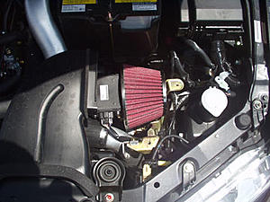

Last one for now. Here is the Buschur intake. SOunds nice, did not really notice any gain in HP though
