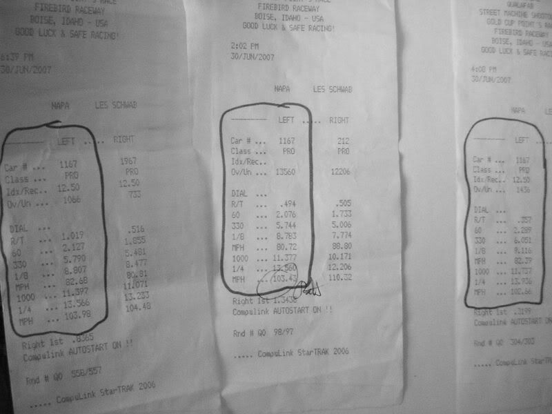

So whats a guy to do? Drive 400 miles a weekend to tune his car? I know at some point I will have a couple maps, but right now what I got is what I got. I figure you (Warr) to be a pretty knowledgable guy, and Id like some input, and not the typical noob flaming session. So was it probably pig rich? Anyhow heres my slips (hanging myself with the ole noose here)
