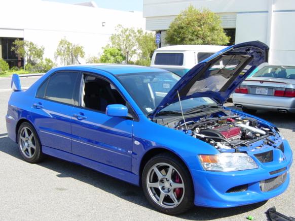

I have done all of the mods above (using RMR parts) as well as hardpiping my intercooler. My car makes 300 whp on the dyno (which translates to about 350-360 bhp).
It runs perfectly, no stutters, at a steady 900 rpm idle.
