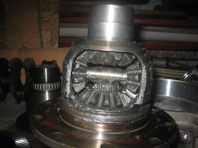

Ok this thread may not apply too well to all of the USA members as I believe from the 7 onwards the transfer case is a bit beefier, as well as the front diff itself. However, I ask for your advice regardless because I need it!
Here is the story, I have a Evo 6, Magnus 2.4, HTA GT35R, Autronic SM4 tuned by Mark Shead, and a bunch of other bits. I'm real happy with the car on pump and on race its really very scary and so I love it.

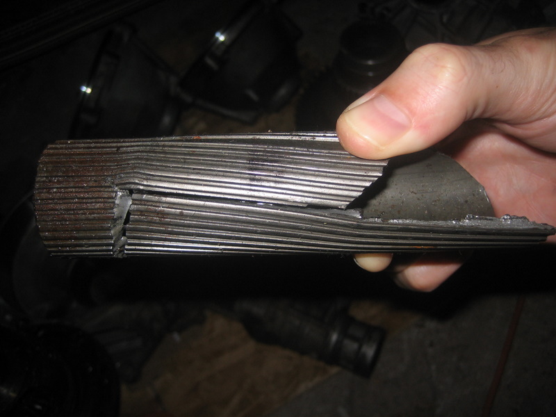

Now the problem is, I keep breaking transfer cases. Here is some pics of the carnage and I'm hoping maybe someone can recommend something for me. Keep in mind the Evo 7/8/9 have different front diffs and transfer cases to the Evo 6.
All four busted transfer cases... one is not pictured as it is over to the left stuck to an old driveshaft! lol
Now here are two pics of the most recent failures... as you can see it is the same thing breaking:
And the other:
Before these two, I broke the output shaft from the gearbox:
And finally, the first transfer case failure I had was bit different. I had not that many mods yet, but had driven the car hard for like 4 years with lots of launches, and I guess it finally gave up. It was working but would click big time every 20 or 30 ft or so. Here is what it looked like:
The last one I think is not too important as it lasted me 4 years. The other 3 lasted me less then a couple months each.
Any help greatly appreciated.
At this point I'm concerned I can never run race fuel again!

Holy carnage!!!! U have way too much power for what seems to be stock transfer cases . If this is the case u should really look into have a built TC.

Maybe put a less aggressive clutch on the car. Also consider toning down your launch. My friend put a Exedy Twin HD in his 370whp Evo IX MR and got a broken hollow shaft just like you've got there, along with a broken center diff, and broken ring gear.

Did you all redesign the hollow shaft or the center diff gears?
