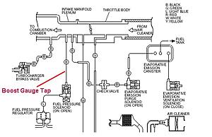

Where is the best line to tap into for a turbo boost gauge? The one from the manifold to the BOV? Thx!

Use the fuel pressure vacuum hose. If you don't know where it is, I think there is a pic somewhere in the install section.

I would use the vacuum line between the intake manifold plenum and the fuel pressure solenoid.

I would use the line from the manifold to BOV. I documented the install using the line from the FPR, but have since switched to the intake manifold. Another user has also noticed some delay in startup when using the FPR line. Nore reason for me to avoid it.

I have mine between manifold and BOV as well, no issues and solid readings on the guage.

The fuel pressure regulators and solenoids are important and sensitive little things. You don't really want to mess around with any inputs to these devices.
I agree with tapping into the manifold-BOV line and will be tapping my gauge there. It is safer and will still give you a proper manifold pressure reading.

Good comments. The vacuum line I referenced is the one the shop manual specifies for a shop vacuum test. I'll try and find the reference in the manual.

i as well tapped into the line going from the intake manifold to the fuel pressure solenoid.
