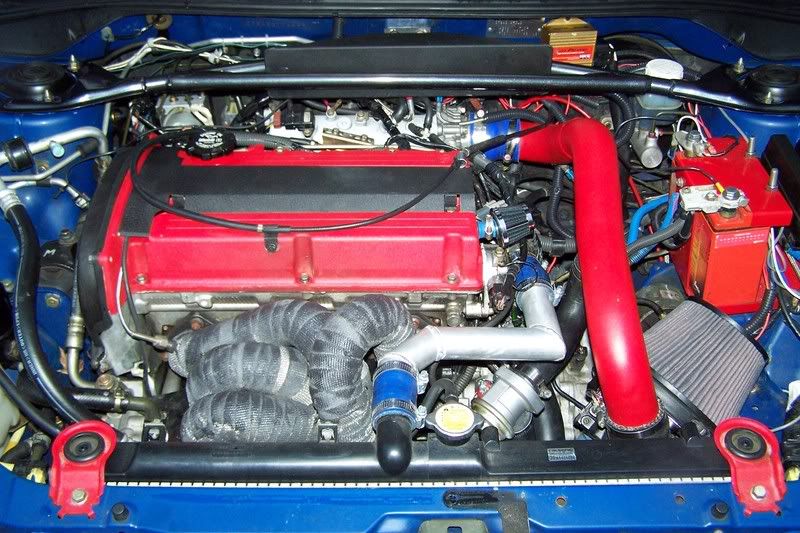

Ok! Here you go. In, out and during.

Wow very nice build. Engine bay looks sooo nice.

The radiator hose leaves me speechless.... I can see what you mean about the manifold needing a little work
