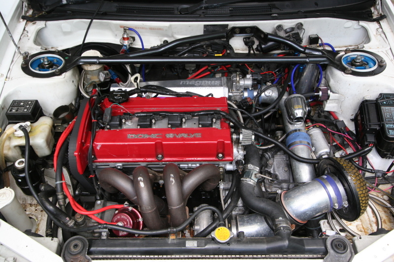

I had HKS IC pipes for Evo 6.
When I installed the Magnus Race, I ended up getting away with cutting one piece of the UICP and spinning it end over end. Then of course I had some bead welded on the end to give a lip.
Here is a pic:
As for what companies UICP might fit without adjustment... not so sure. All I can say is HKS UICP for Evo 6 does not fit without modification.
