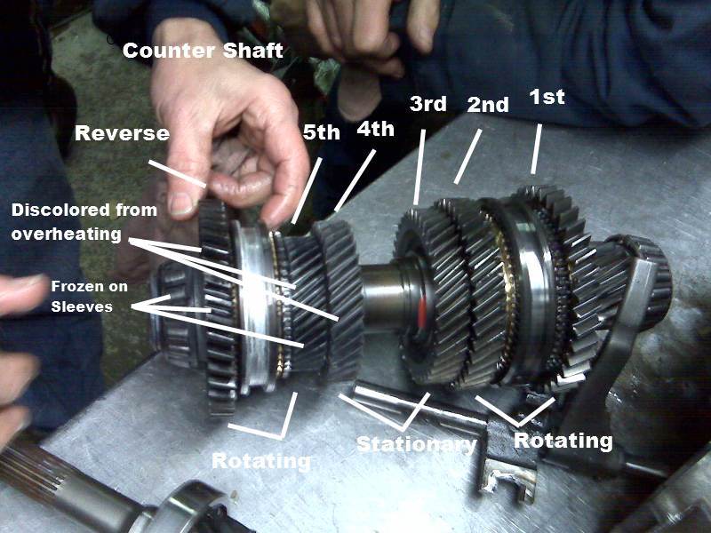

Ran out of fluid on the highway and locked in 5th gear.
Opened her up today. I will need AT LEAST: New 3rd, 4th, 5th, Rev gears/sleeves/synchros and bearings.
Attached Thumbnails Inside my lightly cooked tranny-countershaft.jpg   Inside my lightly cooked tranny-inputshaft.jpg

That sucks shameless. What are your plans, rebuild to stock?
I'm still weighing the options... I will either rebuild it myself with Evo 8 3rd-4th, but I'm not sure if the countershaft is usable... it could become a very expensive rebuild.
I may opt to get a new one from Shep if the rebuild exceeds $1500.
This is definitely one of those "while i am in here" type of problems. One can only hope you wont have the tranny apart very frequently.

Originally Posted by DonHugo
how long was your trannsmission leaking?
It leaked slowly for 3 days and 350 miles after a clutch job before I realized it
I refilled it and the next day it locked up in 5th. Bummer

The shaft is no good... gears and sychros look really really bad from the inside.
Ordered a Shep w/ Evo 8 gears and Double Synchro 5th. Hopefully I can make it to opening weekend at the drag strip.
Any idea what Shep recommends for fluid? I forgot to ask.
