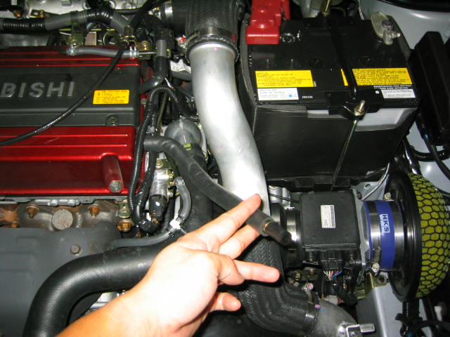

I'm sorry I'm not sure what a diverter valve is. However could this loose hose be the problem? This problem only started after I did 2 runs on the 1/4 mile strip tonight (actually 5hrs ago)

That is the breather hose, it goes into the intake duct between the MAF and the turbo. Yes it could be a problem since you will be sucking in unmetered air into the trubo and it is throwing off the ECU. Easy to put back on.

About the breather hose, can I just seal it noe that I have a different intake system? Btw, I ran a 12.967 @105.01.

I've attached the hose. Got to go test the car now. Hopefully everything will be ok.
