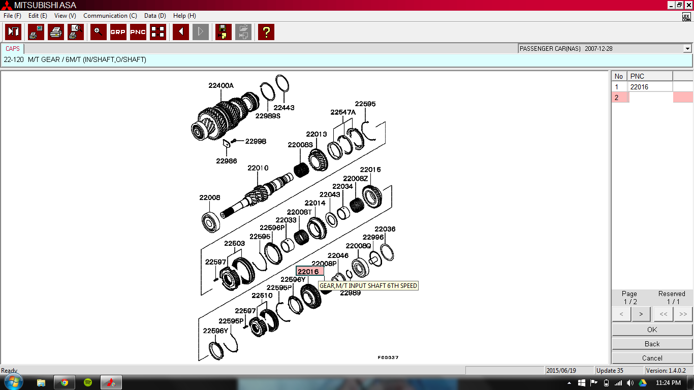

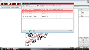

Gonna pull my trans out soon once I get the parts ordered. What parts shall I order when I visit the dealership? Obviously that clip that JohnBradley posted, but what does that clip go into? Do I need that piece too? Any seals/bearings that are an absolute-must to replace?
I currently experience no grinds whatsoever, except once at a high rpm, I had a grind downshifting into 5th gear. I haven't really ran it to redline since then but daily driving it in a civil matter, I'm unable to duplicate the grind.
So I guess my second question is, should I replace anything with 5th gear while I have it all out?
IX with 30k miles. Should I also order by vin? Or is there a better designed part number out of the options? Because the same 6th gear part shows different part numbers depending on production date.
