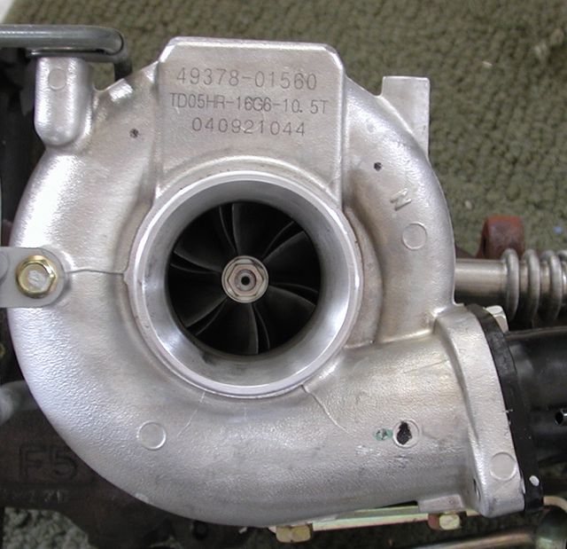

As these guys have said, the Evo 9 turbo has the larger compressor housing. Also, if you look at the flat spot on the compressor cover where the part numbers are, the last 4 digits of a stock Evo 9 turbo (as well as the FP Green Model) is going to be 1580. You can see the part number in the following picture:
To really tell the difference between an FP Green and a stock Evo 9 turbo, you would need to pull the intake pipe off and take a look at the compressor wheel itself.
As far as the Evo 8 turbo, it is going to have a smaller compressor cover on it and I wish I could give you the part number for that turbo, however I do not know it off the top of my head. Maybe tomorrow I'll update my post when I find the part number.

The Evo VIII turbo with the 10.5 hotside has the last four digits as 1560, as shown with the pic attached.
