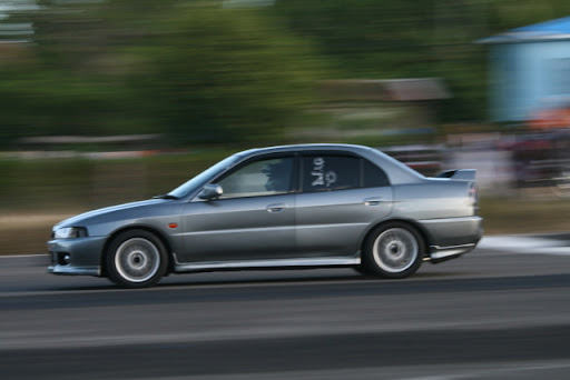

My car is a 1996 Mirage VR-X (JDM Spec) 50/50 AWD. I live in Grenada, which is in the Caribbean, so there is a huge market for used Japanese cars.
The above pic is from a regional drag racing event which was held on an abandoned airport strip in Grenada. Best time of 14.022 @ 96.77 MPH @ 15psi.
The car comes with a 4G93T (1834cc) engine with a TD04L-13g turbo. Mitsubishi rates the car at 205bhp.

thanks for sharing with us, I like the car a lot looks very clean. that 13G turbo must be very responsive. the 1/4 mile time is pretty impressive the setup you have.
What kind of wheel is that?
