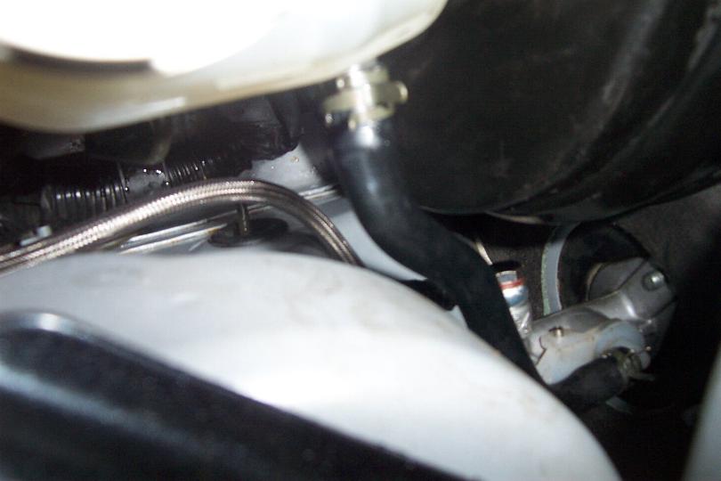

here is where it connects to the hardline. I followed timz instructions. Very helpful. thanks
Old Aug 31, 2003 | 08:35 PM
  #126

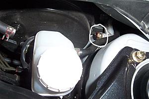

here is where it attaches to the strut tower. pull the clips with a pair of plyers.

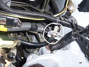

finally the banjo. Have you girlfriend do it. It's a tight space.

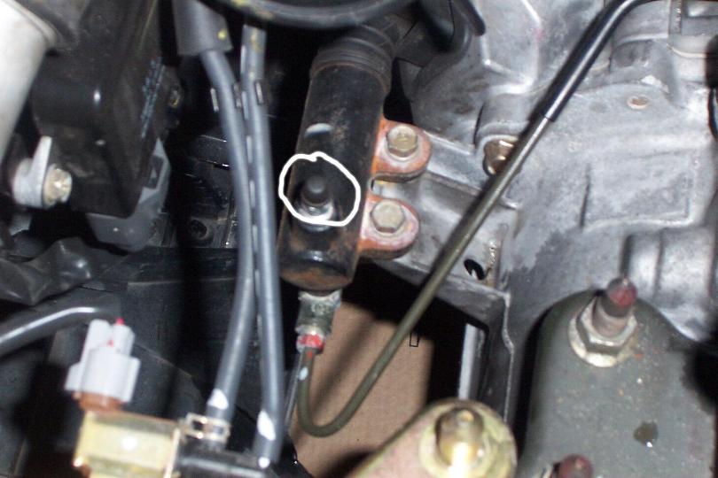

run it down around the wires and hook it all back up. Then pull the little rubber dust cover off the slave cylinder and loosen the bleed screw. 10mm. I used an old piece of my grandma's oxygen tube for a bleed tube and pushed the clutch pin back and forth until no more air bubbles come out. I had to keep filling the Master cylinder about every 10 pumps to keep it full. If it drops too far it will hiss cause air gets in and you have to start all over again. so make sure it stays full. To get to the clutch pin undo the two bolts on the slave cylinder and pull to it out to the right. If you are removing the ristrictor DO IT NOW before you start bleeding the system. Just take out the slave and remove the banjo. then poke the black plug with something until it falls out. Remember the monkey and the ant hill. Then pull the spring and put it back together. put it back on the car then bleed.

Due to my big hands and forearms, the banjo fitting was a real pain in the ***! To uninstall/install the banjo, you have to "one hand it" between and behind the master cylinder/brake booster and the strut tower. You only have about 2.5 or so inches of space to reach through. The only addition I made to the instructions already posted on the install of the part is I slightly bent the neck of the banjo fitting toward the passenger side for a little more clearance with the strut tower. That fitting is hard as hell so I wouldn't recommend this to others as you may break/damage the piece trying to bend it. I had to put the fitting in a new, smooth jawed vise (to protect the fitting surfaces)and push my 250lbs on it to budge it... keeping in mind you only have about 3/4 of an inch of neck on the fitting to push on.
