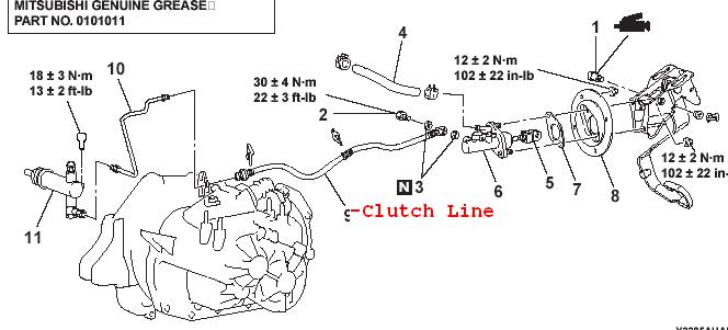

I was thinking that it was odd that the left-hand drive Evos are having so many more problems with the clutch than the right-hand drive ones, and that clutch-feel has never been a visible problem on RH cars.
The transmission layout in RH cars is identical to LH cars, so wouldn't the distance from the clutch master cylinder to the connecting point on the transmission be almost twice as far on RH cars?
I dug up an Evo shop manual page on the clutch for RH cars... and it turns out that 90% of the length from the clutch master cylinder to the transmission is a steel brakeline-type pipe, only the last few inches are rubber! I'm sure the short rubber length of hose only allows for movement of the transmission relative to the chassis.
Anyway, nothing conclusive, since the Evos have probably been made this way since the first Evo left-hand drive model was produced, but it is interesting.

I ordered mine too and waiting to get it but I have not a clue on how to change it and how to take off the restrictor thing everyone has been talking about. Should I take it to a shop to do this for me?
From the shop manual:
CLUTCH BLEEDING
CAUTION
Use the specified brake fluid. Do not mix brake fluids.
Specified fluid: Brake fluid DOT 3 or DOT 4
1. Connect a hose with a bottle to the bleeder screw.
2. Open the bleed nipple.
CAUTION
For bleeding, never "pump" the clutch pedal. This may
cause an oil leak at the clutch cylinder.
3. Depress the clutch pedal slowly. Open the bleeder screw to
let air and brake fluid out. Close the bleeder screw. Release
the clutch pedal. Repeat until only brake fluid and no air
comes out.
4. Check that the brake fluid reservoir level stays between
"MAX" and "MIN" marks throughout the clutch bleeding
process.
