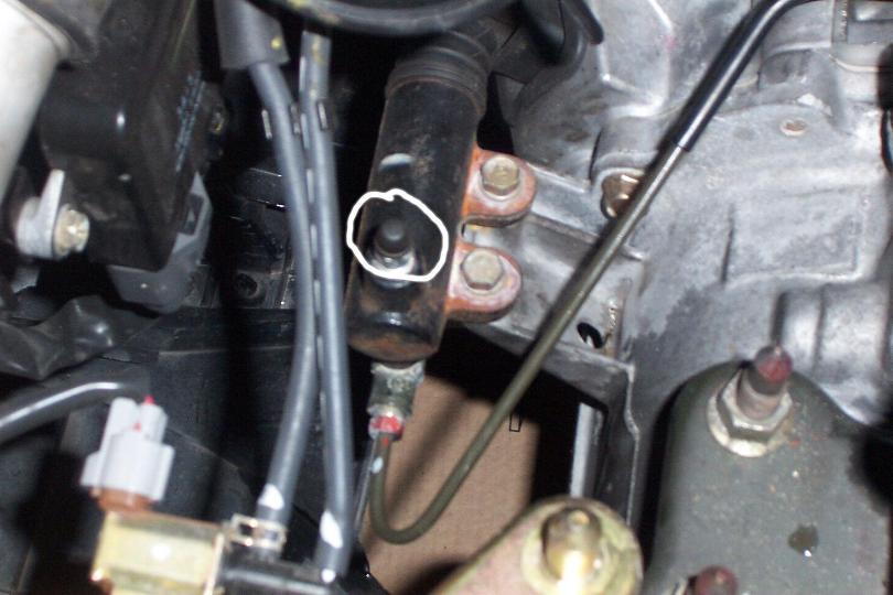

REmove the restrictor. It's the most important part of this mod. The hose disengages the clutch faster but taking out the restrictor makes it so that the clutch doesn't feather automatically causing it to burn a little every time it engages. Before I did this I could always smell my clutch even under normal driving conditions.

my clutch is currently slipping... if i install this SS line now, will it effect anything?

is it hard to reinstall the restrictor for warranty purposes?

It was really easy to take out and should go back in smoothly. Just a spring and plastic piece is all it is.

Where is the clutch restrictor located? I'll be doing this mod along with the new SS line.

It's in the slave cylinder under the turbo. Black chunk of metal that the hard line goes into. remove the banjo bolt and it's under the bolt.
