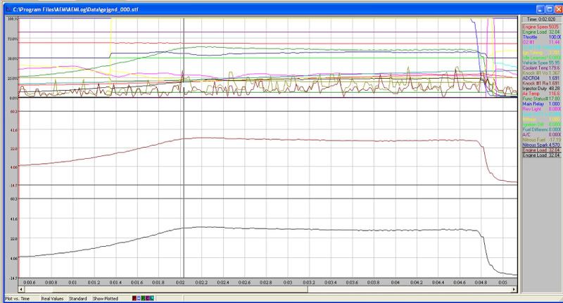

I have not been on here in a little while but I wanted to post something that I found on a car I was tuning.

This car was tuned here in Colorado so we are at about 5500ft or so. On pump gas I tuned the car to 26psi and with the alcohol on I tuned it to 33psi.
Conservative timing and AFR, we could have gotten more out of it but I wanted to leave it safe.
I have posted some screen shots of some of the logs. Check out the boost!! We are getting full 26psi at 4700 rpm, and 33psi by 5000-5200!! At this elevation that is crazy!! Car really screamed and the customer was super excited in the new found power.
I was not a firm believer in the HTA but I really think different at this point. It really made boost quickly and the car ran great.
I did not get any dyno numbers but he is going to go with an intake manifold and then it will go on the dyno for sure.

The double pumper is awesome. I had no idea it would help so much but it made a huge difference Dave. Good job on building such a great motor, but I think we all know you are't too bad at that lol.

I dont have a JDM MAP or an AEM to log boost but if I watch the tach and listen for the WG and have people watching the gauges. We all agree that I get 25 psi right aroung 4600 in third gear.
I have the .63 5bolt tubular kit and love how fast it spools, faster then the bolt on 30R on a heavily ported 2g mani on my DSM on race gas running similiar to slightly higher boost.
That is pretty good, is that in 3rd or 4th gear? Nice results!
Old Aug 6, 2008 | 09:58 PM
Magnumpsi's Avatar
Posts: 1,045
From: Who Knows
That is in 3rd gear. It really gets moving quick.
