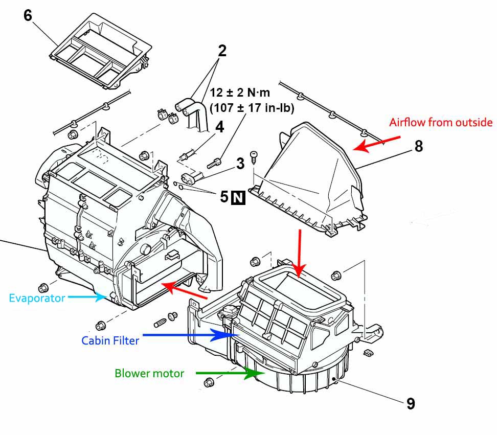

Please note that some cars have cabin filters inline before the blower and evaporator. I know my '05 does. You might want to open this cover up and spray an anti bacterial solution in this way. Otherwise spraying from the outside will only soak up into the filter.
