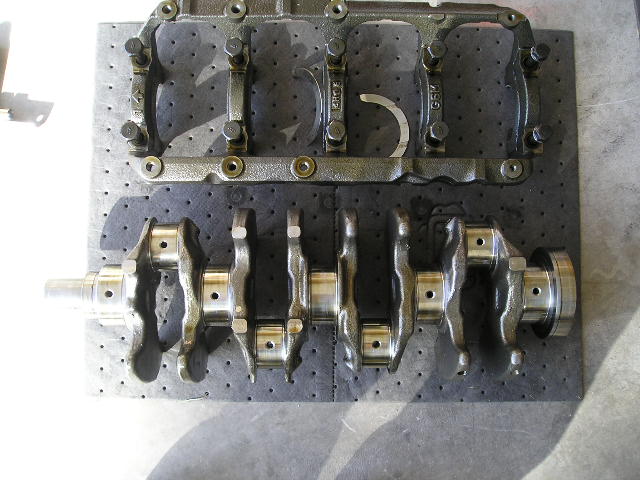

Crank ready to come out
Crank removed

I removed the oil pan last night. The thing was full of metal shavings. Thats interesting because I thought When I drained the oil I didnt notice and metal in it. I suppose it came from the piston when it broke apart.
I dunked it in a solvent tank this morning and cleaned all the old seal off. I need to remove the oil filter housing and do the same.

I disassembled the old motor this morning. The only thing left in it is the oil squirters. Apparently the metal in the oil pan was all piston. The bearings are slightly scored from it but the crank journals are clean. None of the bearings were spun.
The balance shaft surprised me. I never realized how much it actually weighs. Same for the oil pump. I wasnt expecting it to be designed like that. I guess it comes from working on older cars where the pump was an external housing. I have never rebuilt a mitsu eng before.
