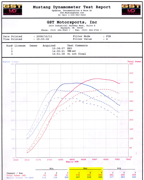

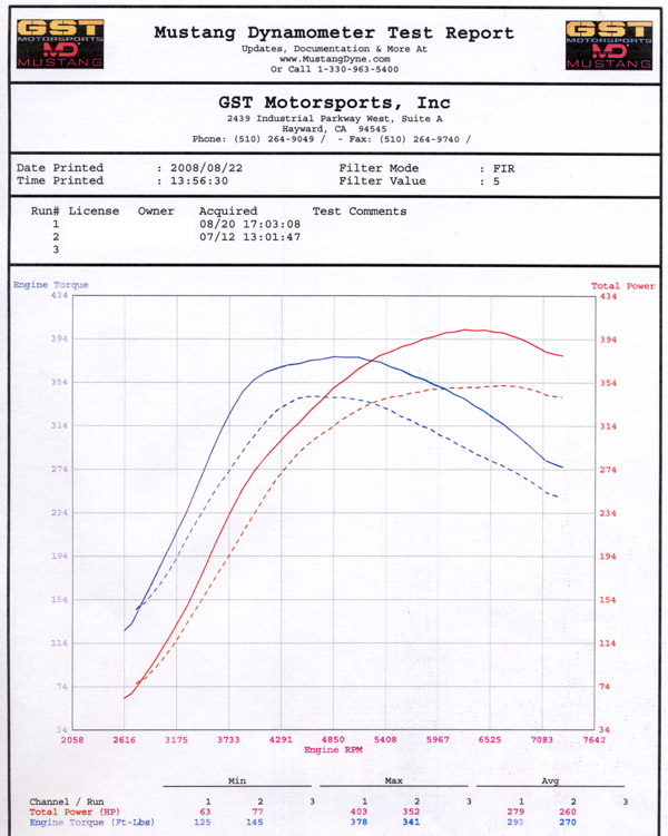

E85 makes much more power than 100. Some examples:

^^ Very nice comparison!

great comparison...made up my mind about what I want to run

Just switching from 100 octane or pumpgas to E85 with the same boost level and ignition timing, and only dialing in fuel to the desired afr; you'll make more power and torque accross the entire powerband and pick up spool.

Indeed, last couple evos, with the same ign timing, boost and even AFR as pump picked up 20-30wtq just by adding E85
