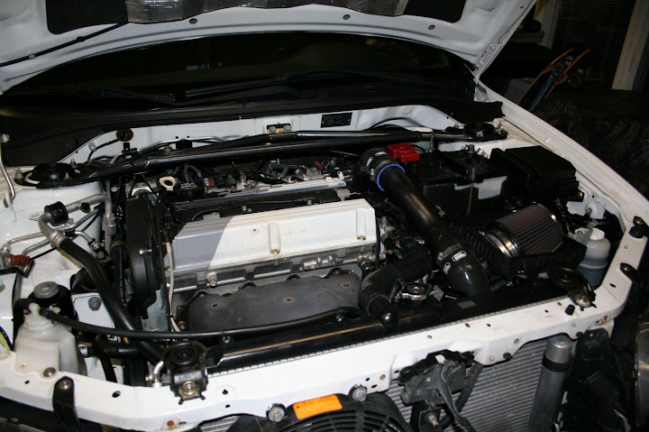

Here's my take on my stock air box. I modified my air box to accept a second K & N filter on the side. That filter gets a straight shot of air into the MAF. I also have a drop in K & N in the stock location. This mod allows me to maintain 24 psi until redline with my FP White. Once the box is bolted back in the engine compartment, everything looks completely stock.
StealthAirBoxModfoweb-1.jpg?t=1225157492
StealthAirBoxModfoweb-2.jpg?t=1225157554

Nice big-breathing, camoulflaged box, EvoTio. A+ for ingenuity. I like it............
