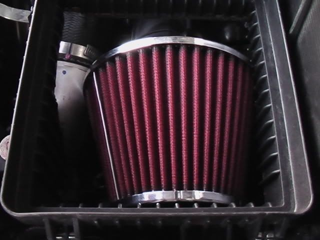

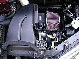

Ok.. I discovered I can have the best of both worlds, Fresh cool air, and a large open element air filter.. In addition, You would be hard-pressed to tell that this engine compartment was anything but stock..

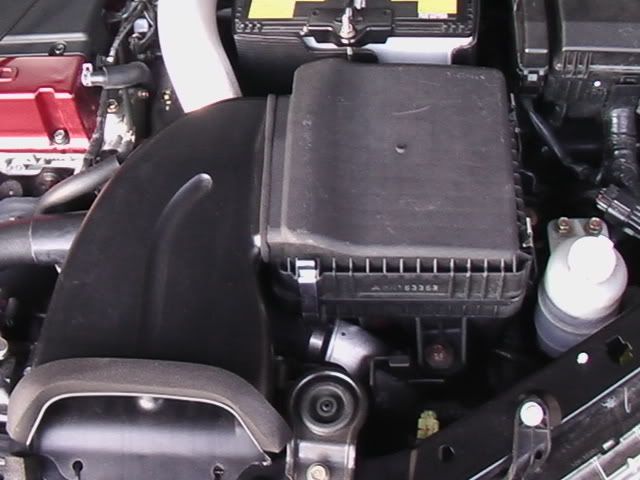

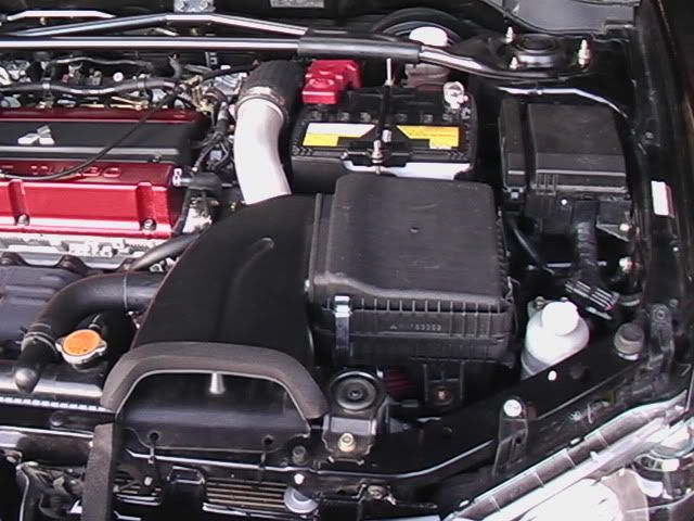

SURPRISE!!!

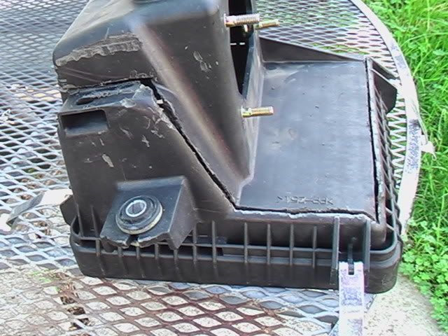

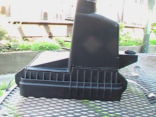

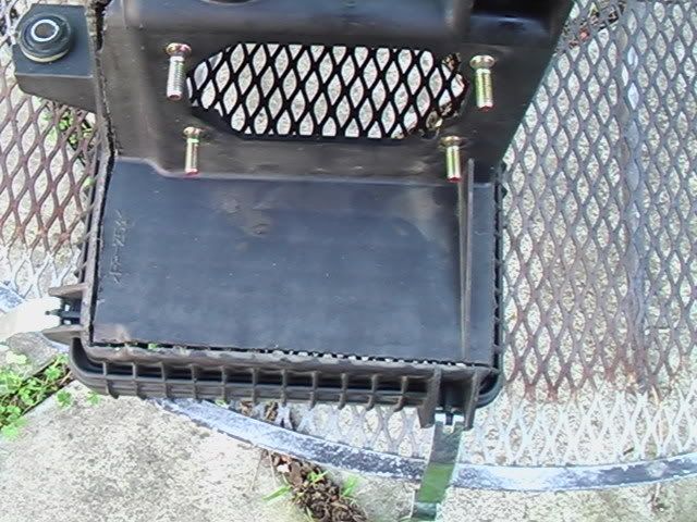

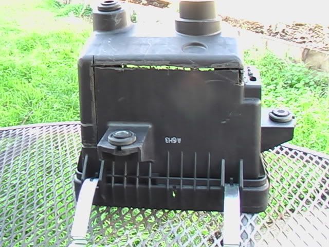

Here are some more pics that show exactly where I cut the airbox:

Ok.. here are a few details so you can make your own... Basically you need a cutoff wheel that is small so you can make clean cuts and corners.. Cut out the entire bottom portion of the airbox except for the mounting tabs (That bolt to the brackets underneith)
Now, at speed you have the advantage of cool air being ducted to the air filter from the stock location, it doesnt restrict airflow should the engine demand more flow, it can be drawn in from the bottom.
I came to this little mod because I discovered a low pressure area where the air filter is, which means at high speeds and high RPM the engine can get starved for air.
One side effect is that Every aspect of a custom air filter would be hidden from view.

so did this affect performance?

Yes, the car doesnt feel as starved for air nor does it stumble at part throttle anymore at higher speeds.. I did it for looks more than function, but it in no way adds any additional restriction because the air can still get around the box if need be..
