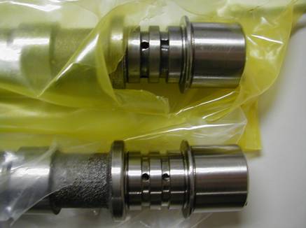

Kelford has been working diligently to find the cause of the mivec cam breakages. We appreciate the useful feedback most of you have been giving us that we can use to help pinpoint the problem.
As pointed out by Kelford earlier in the thread, the cams that are currently being supplied to Motovicity (and have been sold since Feb of this year) are the same as used in the FP cams as well as a few other cam companies out there. We have not had any reported failures of these cores. Until the exact cause of the failures has been pointed out in the other cores, these cores will be used. For all we know it could be something as simple as damage in shipping, which we have also switched our packaging to further protect the cams.
The difference for the two cores is obvious, see pictures attached, both Kelford cams. The picture with the shallower oil grooves is the current core we have been selling.
We have also replaced a few of the old cores from customer that have came to us with concerns.
We do recommend running Bee Hive springs with the evo 9 cams, we do not recommend using dual valve springs.
Pawel - Motovicity
Attached Thumbnails my intake cam snapped?!!?-image001.jpg   my intake cam snapped?!!?-image002.jpg
