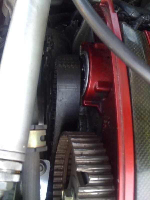

Originally Posted by JohnBradley
I know, I had that one coming. Here are some pics:
Not sure what one is the batch number or not. I still feel its not necessarily an inherent design flaw its just whatever outside force acting on the cam breaks it there and thats the weakest point. I think its silly to be afraid of the cams though still. I have run my car over 8k for 46k miles on 2 different sets of GSC cams. We have done numerous Cosworths, Tomei, Greddy, etc. and not had a problem till now. If it is an RPM thing I would assume people like Most Wanted and Brandon with the TT built IX that run over 9k would have had failures already.
I am not sure your statement about the FP core is correct.
Im not sure you can say that because, apparently when they change the design, the problem is solved.......
Weather or not there is an "outside force", the DESIGN of the cam is not holding up to the force, therefore the design is FLAWED (material, dimensions, etc).... FP cams and the new kelford and GSC cores have not failed therefore, one could conclude the design is better.....
I still do not understand why the "outside force" you speak of is only present in the OLD Kelford, GSC, Cossi Cores , and the stock cores are not breaking.....
We have seen at least 4 failures already, with many different set ups, including one set up that was stock valve springs, stock mivic tables, stock rev limit.....
You can keep them in your car, but I certainly wouldn't want a ticking time bomb in my car..... there have been enough fail to convince me there is a problem..... Lucky I have an 8

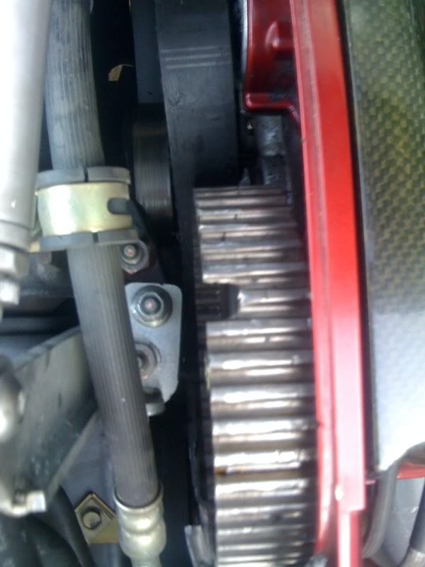

this was our third set we saw break from one of our customers. its actually the 4th set we've seen broken, but one of them was installed by a shop in AZ.
this is a cosworth M2, with cosworth dual valve springs. car had these springs and retainers in them for over a year with no problem. after installing the HTA86 turbo it lasted 2 days. it broke at the rev limit which was 8400rpm if i remember correctly. so you can imagine, the mivec gear broke into many peices, the exhaust gear is broke, belt is gone, belt cover is gone, broke an inner spring, belt valves and pistons have impact marks on them. (sorry, iphone pictures)
to date, we have seen a GSC S2 cam, Kelford 272, Cosworth M2, and the Cosworth M2 installed from the shop in AZ (that one lasted one day from being installed... he was still breaking in his new motor, low revs, no boost)
Valvetrain harmonics are still a number one suspect. The one that broke had really stiff valvesprings in it, is revved to 8500+ frequently, and makes 546whp. There are alot of outside forces acting on the valvetrain that you might not be aware of. Since you brought up a really old post after I already acknowledged a problem, I can add that I still have 3 years on my S1s (in circulation, old design) and now almost 2 years on my S2s. It is obvious that the foundry had/has something of a QC issue on the cams that snapped.
As has been pointed out though, the problem is fixed with the new designs in all the cams that have failed. It doesnt change the fact that everything is still acting on that part of the cam. It is the longest unsupported part of the cam and has the most weight acting on the outside edge. It will always be where the cam breaks as the most force applied is right there regardless of what design is used. If the force gets high enough, count it gone...any cam/any design.
I run, will continue to run, and continue to sell GSC, Cosworth, Kelford, Tomei, Greddy, FP, and any other brand IX cam that works. I am not afraid of failures and have seen only the one so far. Alot of the extra damage is how you respond when you hear something start to not sound right. Push in the clutch, kill the motor and coast to a stop without letting the engine turn over and believe it or not you can prevent bent valves.
The one failure we had, the driver was on his game and shut down and didnt even hurt anything. It might sound far fetched but it was so obvious to me that the driver has as much to do with damage control as any failure it needs to be pointed out.
