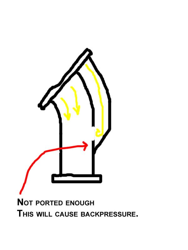

Before you start porting more, take a look at the O2 housing again. It's definitely worth a look. It might be your problem.
Some aftermarket O2 housings have an issue where they don't open up the area enough, where the wastegate portion flows into the exhaust stream. The wastegate tube is quite large but they barely open up a big enough hole for it to flow into the exhaust stream. The flow from the wastegate portion runs into a wall causing backpressure and reducing flow.
My aftermarket O2 housing had the same problem. I fixed it by porting out the wall that would have caused a restriction.
Here is a drawing of what I'm talking about:
On mine, this wall was huge. It wasn't even close to being a smooth transition. The wall on mine was almost 1/2 inch tall.
Good luck
Good luck

Try porting the merge(crossover) opening in your O2 housing, as BLUEvoIX, and, INEVOIX advise.Make it about golfball size.
EDIT: If porting the O2's crossover hole doesn't fix the creep issue then you may have to pull the turbo's turbine housing and radius the entrance to the wastegate bypass port(s) in the turbine inlet area of the housing.
