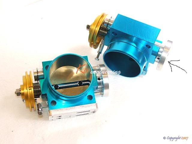

Okay i have a circular plate that holds down the tps to the throttle body(pic 1), it has 7mm bolt holes to hold down the tps and 10mm bolt holes to hold the plate down to the throttle body. my tps is set at .5volts but i can not line the bolt holes up with the pre set holes on the throttle body.
