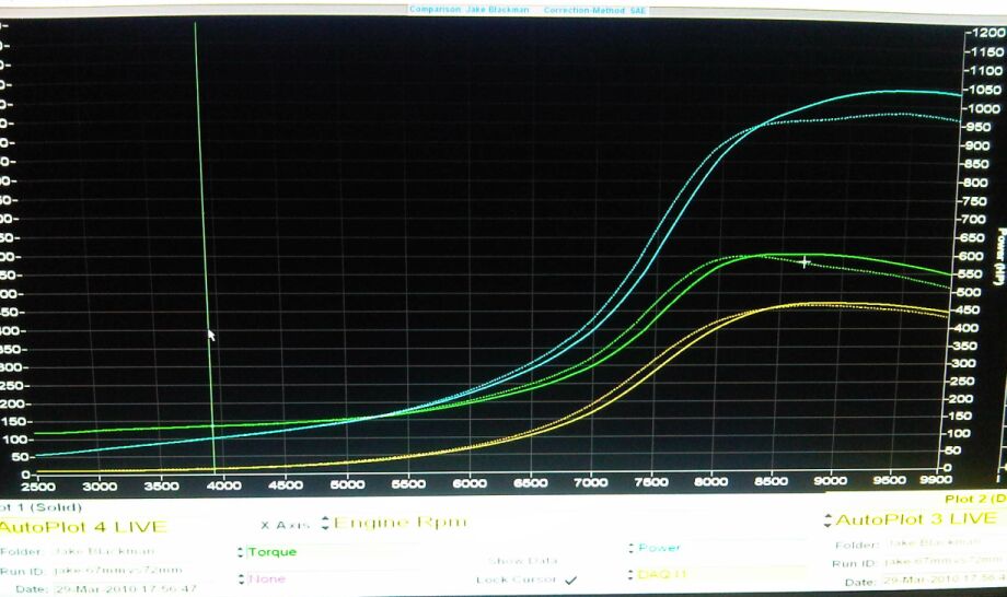

2) if you havent seen any impressive power, are you looking hard? Here is a 1000whp drag b series honda, that goes consistent 9.4s. 67mm S400SX vs 71mm S400SX
