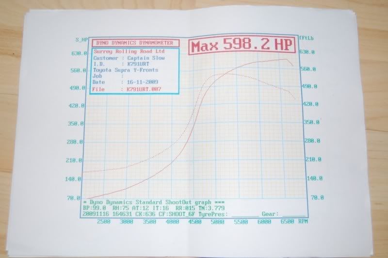

here is an interesting result from a BW 91-79 *singlescroll* .88 a/r Stock 2JZGTE 1.4Bar boost 98 octane --
its a mostly stock 2JZGTE engine with HKS 264s, BW S300SX 91-79 turbo singlescroll .88 A/R and hks 264 cams, making great power with quick spool, solid in the mid 3000rpms.

very impressive Geoff on that 2jz, those are fairly mild cams and a small hotside for a 2jz making some awesome power
