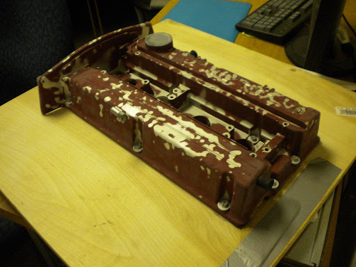

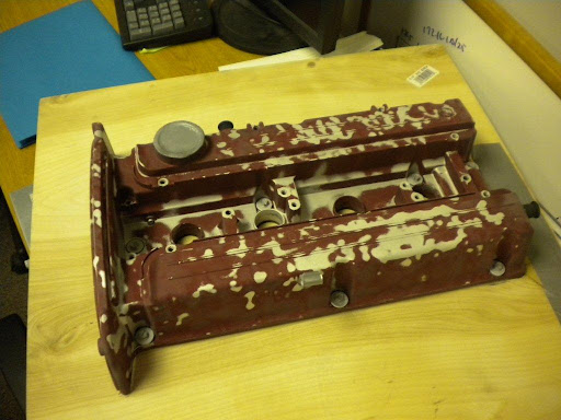

Glass beading is a great way to get abrasive into your motor, and it's almost impossible to get out of a valve cover...
This is very true.

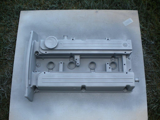

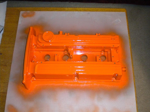

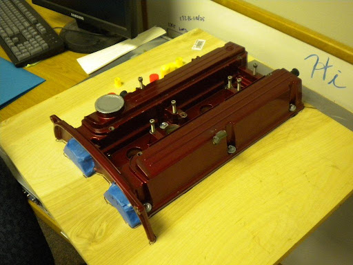

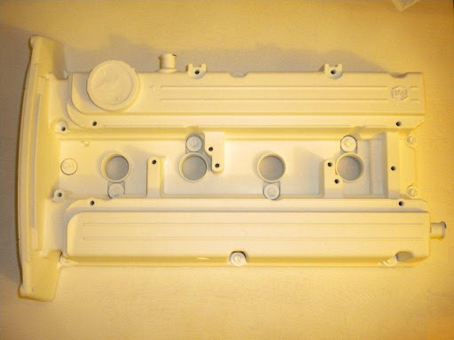

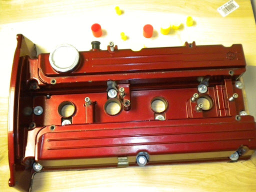

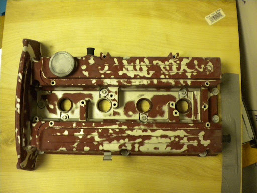

I taped up the baffles underneath. I then put the gaskets back on the valve cover and bolted it to 3/4" piece of 2x2 plywood. I taped off all other holes, used some card board and rubber plugs.
When I was finished glass beading it, there was a little bit underneath the valve cover - I wiped it clean, then ran water over it - then let it soak. I then ran quite a few gallons of water through it and used many towels and Q-Tips to make sure I was good.
I let it dry overnight and took it out to my garage and hit it with compressed air for a while. I don't feel / see any media at all. It's good to go
-Bink

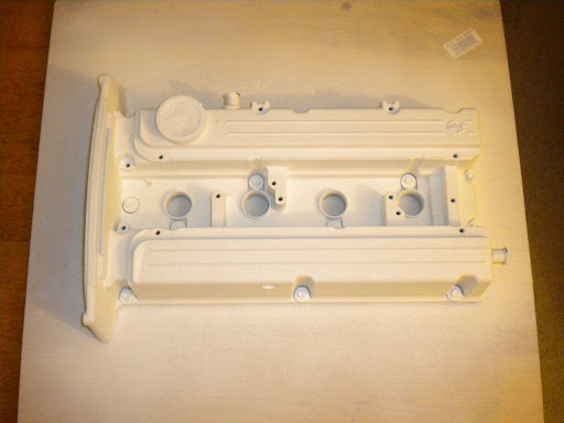

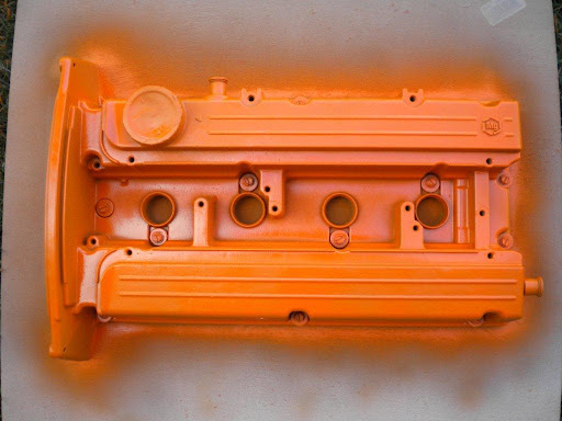

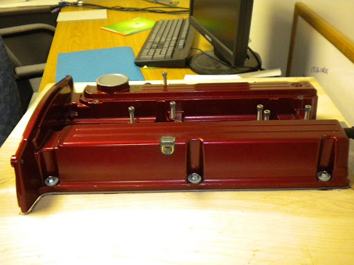

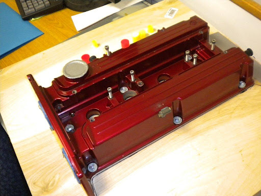

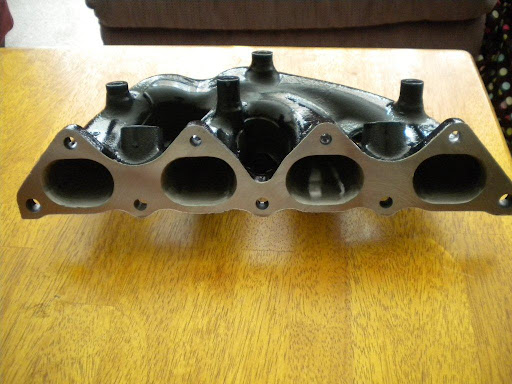

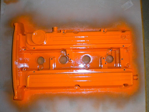

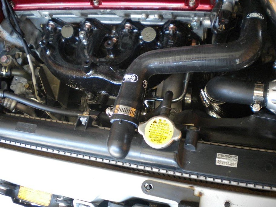

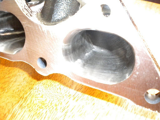

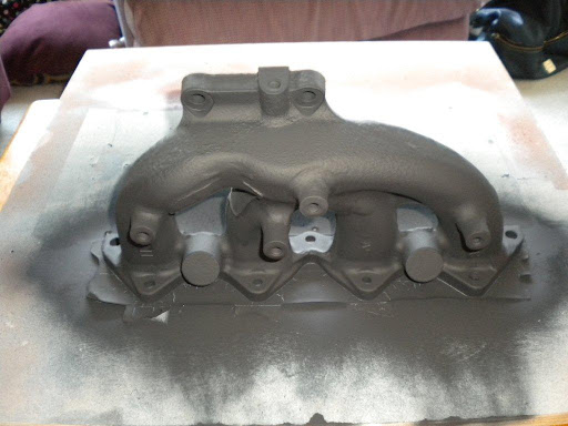

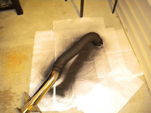

Update -

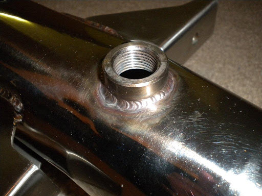

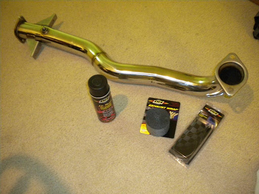

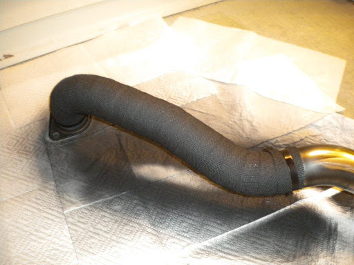

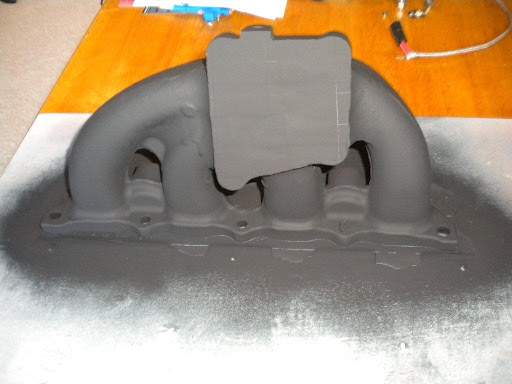

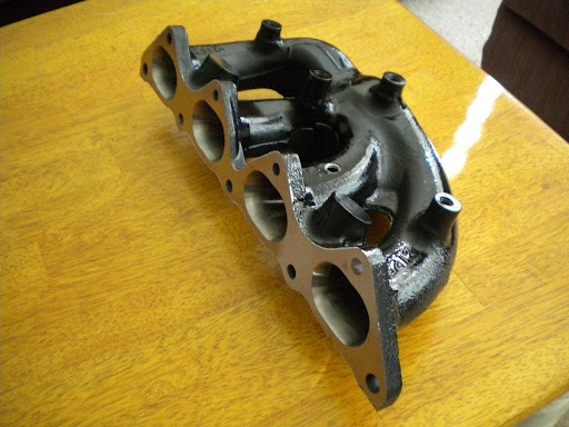

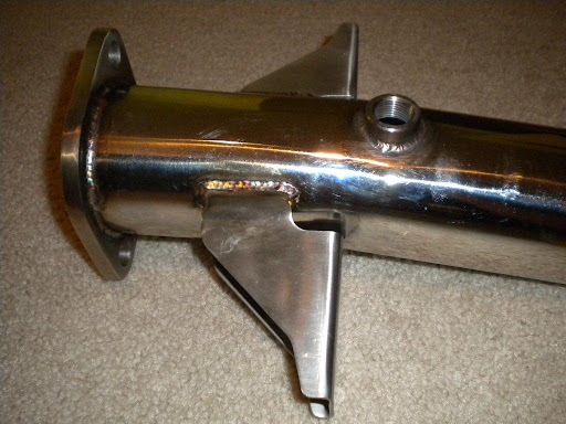

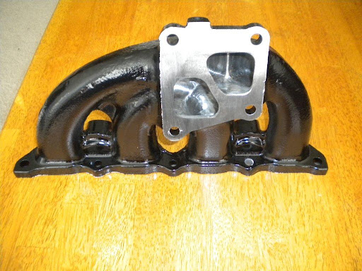

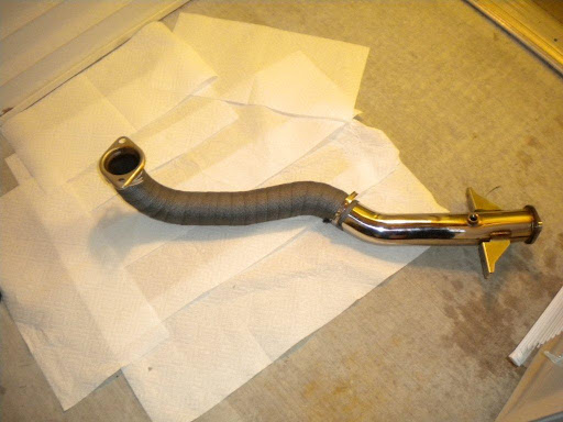

I cleaned up and painted my valve cover with VHT paint. I also cleaned up and painted my MAPeformance ported and polished exhaust manifold. I wrapped my downpipe with DEI exhaust wrap and welded in a bung for my Wideband and also coated it with a silicone spray.
Had the turbo in the car last night but turns out the install kit doesn't come with the eye-bolts for the water lines. I ordered them from Mitsu today.
Slowly but surely....I'm getting there.
-Bink

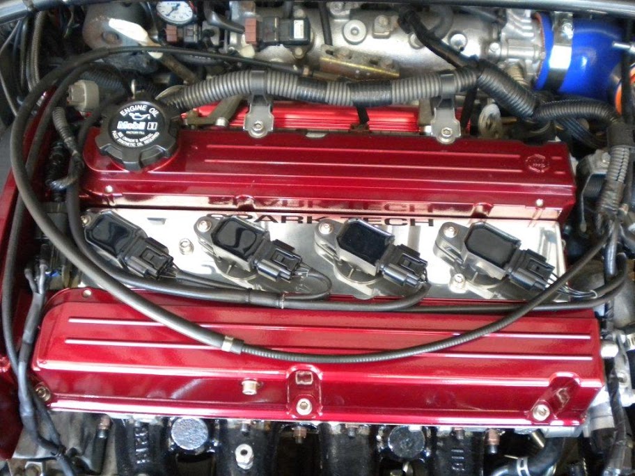

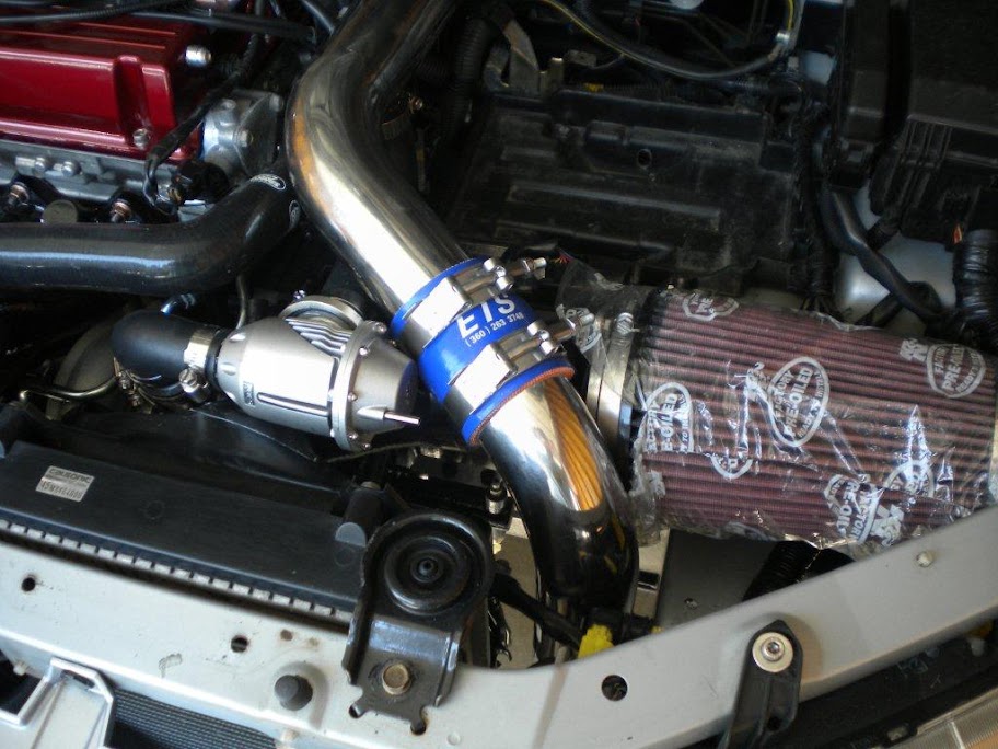

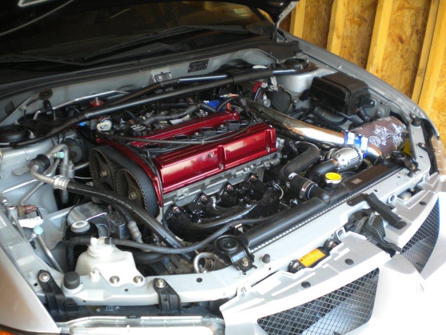

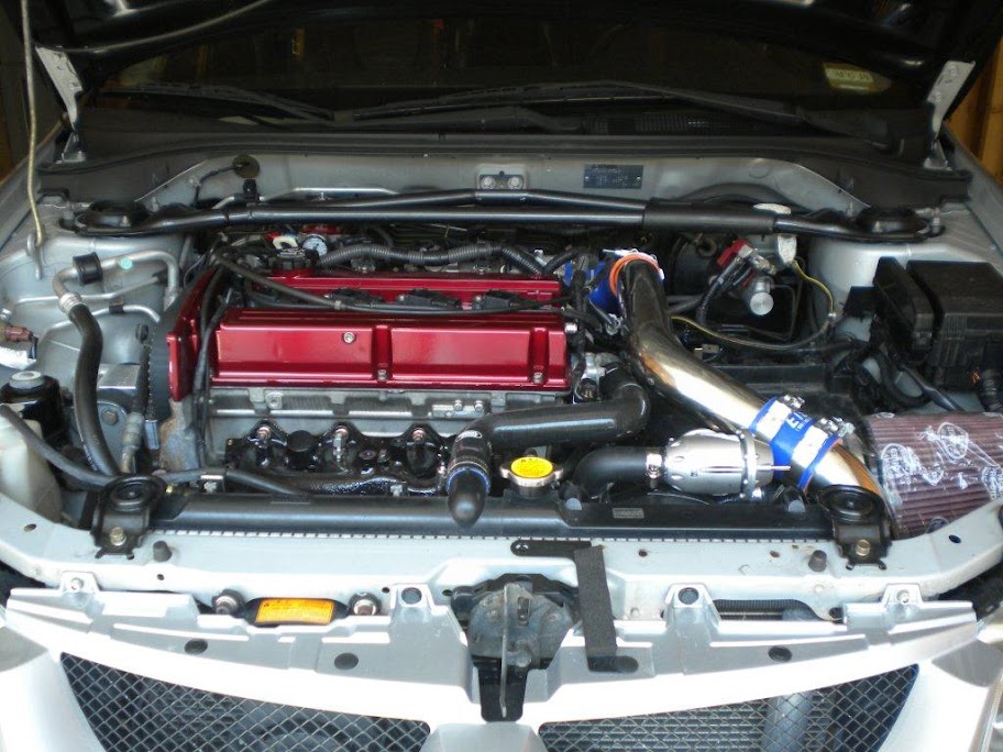

Here are some more pic's. Hopefully I'm gonna start it tonight if all goes well!
-Bink

don't forget to remove the wrapper off of the air filter jk it looks nice
Old Jun 21, 2010 | 07:09 AM
  #157
binky's Avatar
Joined: Oct 2007
Posts: 1,430
From: Connecticut / Massachusetts U.S.A
Haha, funny story....
I was at a family party yesterday and they were asking about my car. I pulled up the same pics to show them, and every time I showed someone they said the same thing....what's the plastic wrapping there on that purple thing??
I'm just trying to keep it clean until I start it !
-Bink

Originally Posted by RockmanX
so you got the whole race pipe situation done and straighten out? I got the race pipe on abbey recommendation i talked to Fp about which pipe to get and he told me get the race pipe and just cut it. Abbey said its larger so pushing more air/gas etc so dont get the reg 9 pipe. so i did. of course i dont have to handle it as JMS is putting it together but i knew it would be a pain to install.
Yes sir, I ended up cutting my ETS LICP because it was the easier of the two to cut and it allowed for a cleaner install than cutting the race pipe itself.
I'll snap some pics of that tonight
-Bink

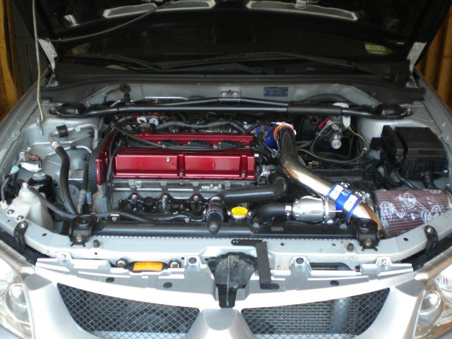

She lives....
I just got her started
-Bink
