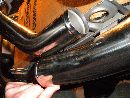

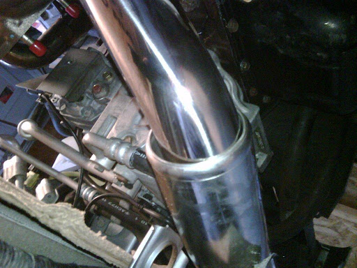

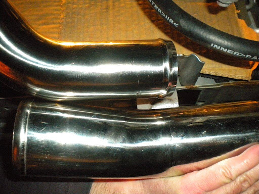

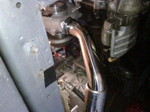

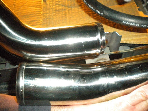

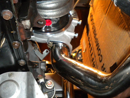

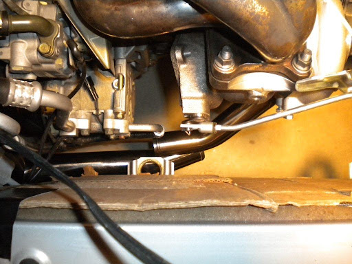

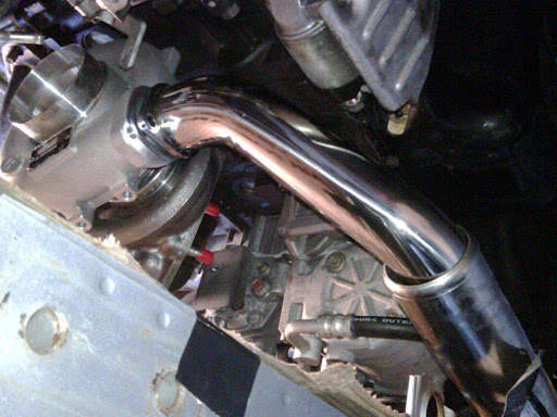

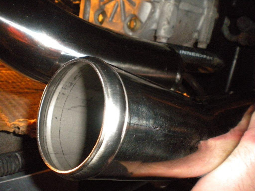

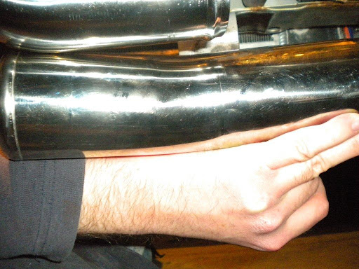

Hey guys,
Sorry for not updating sooner. I have been saving money for a bunch of parts and finally bought everything I need.
Anyways here are some pics that I've been snapping while I've been in the trenches (with my cell phone, GF has my camera) pulling this thing apart.

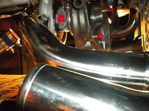

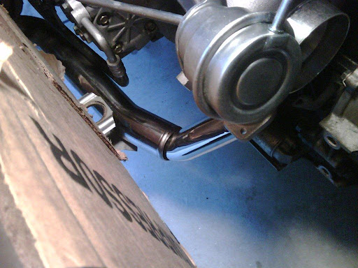

I have run into a problem with my ETS LICP and my FP compressor outlet pipe.
As you can see in the pictures below its to long.
I have 2 options:
1) Cut the FP compressor pipe and get a new roll bead on the pipe or cut the pipe and re-weld the existing roll bead back on. I would rather cut this pipe because the pipe diameter is smaller than the ETS LICP.
2) Cut the ETS LICP and make my life easier - however, will I be losing power due to the fact that I cut the larger diameter pipe instead of the smaller diameter pipe? (i.e. that I could have a larger diameter pipe for longer)
What do you guys think? Which is the best way to go? Does it really matter which pipe I cut?
-Bink

Old Apr 27, 2010 | 04:03 PM
  #132
wizzo 8's Avatar
iTrader: (35)
Joined: Mar 2005
Posts: 3,836
Likes: 14
From: Chicago suburbs
You ordered the race pipe thats why. Cant you reuse the stock outlet pipe?
Old Apr 27, 2010 | 04:08 PM
  #133
binky's Avatar
Joined: Oct 2007
Posts: 1,430
From: Connecticut / Massachusetts U.S.A

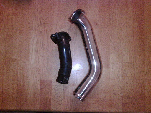

Yes I did order the race pipe. I wish at the time they told me it was for Buschur IC's only.
I can't use the stock compressor outlet pipe because its the VIII's pipe and FP told me not to do it because it will be touching the starter.
I guess I could order a IX compressor outlet pipe.
What pipe are you running on your Black?
-Bink
Old Apr 27, 2010 | 04:14 PM
  #134
wizzo 8's Avatar
iTrader: (35)
Joined: Mar 2005
Posts: 3,836
Likes: 14
-Bink
You dont want to know what I did but I will tell you anyway. I did what you did and ordered the race pipe and wound up in the same boat as you. I was pressed for time so I used the original outlet I had that came with my helix lower i/c pipe. It was hitting the started cable so I did what I had to do. I c-notched the started cable lead that bolts to the starter. It clears but its close. The rubber boot is also protecting it. Im going to get the correct pipe but for now its ok. I havent had any starting issues either. Im not recommending it but it can be done.
Old Apr 27, 2010 | 04:18 PM
  #135
binky's Avatar
Joined: Oct 2007
Posts: 1,430
Haha, good times, isn't it??
Ahh- I can't decide what I should do. I'll have to sleep on it.
-Bink
