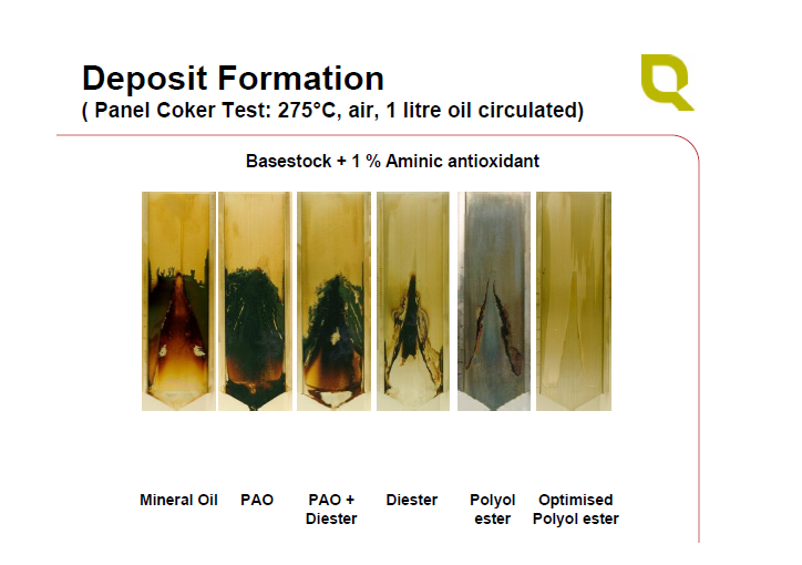

Originally Posted by Jeffs2006EVOIX
Apagan01, would you agree that an oil with a higher flashpoint would be less likely to leave deposits on lets say the turbo journals? Example. If you have an oil that has a flashpoint of 430F vs one with 460F same weight oil, the higher flash point would be the better oil to use in a turbo application? To prevent "coking" as much as possible.
It would only matter if the oil sees flash point temperature, and would also depend on how "cleanly" the oil actually burns. Most motor oils, even in unadditized form, burn "dirty".
Here's an example of how the cleanly the various base oils burn.

Originally Posted by apagan01
however keep in mind that the base stock used in the AMSOIL fluids being a fully synthetic will not release much or any at all simply because of the molecular structure there is not carbons in the oil simply because there is no petrolium base stock, AMSOIL is purely synthetic no petrolium base stocks,,
PAO is not a clean burning lubricant, see the picture above.
Did i ever mention PAO in my post, NOP i do not think so, so please dont put words where they dont fit.
Old Jan 24, 2011 | 11:17 AM
4VsofFury's Avatar
Joined: Jan 2011
Posts: 4
From: USA
You said Amsoil, and since Amsoil formulates with PAO base stocks in their oils (except for their XL and OE lines which use group III), what else could you have meant?
If in doubt about Amsoil's use of PAO, look to Amsoil's own logo:
