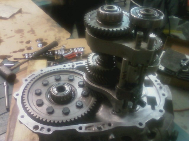

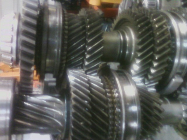

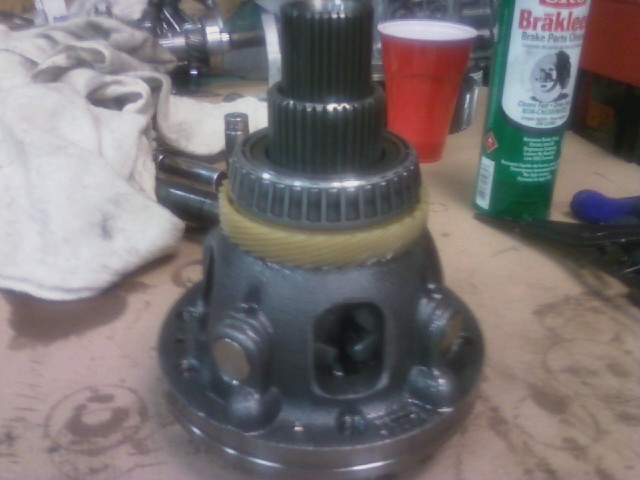

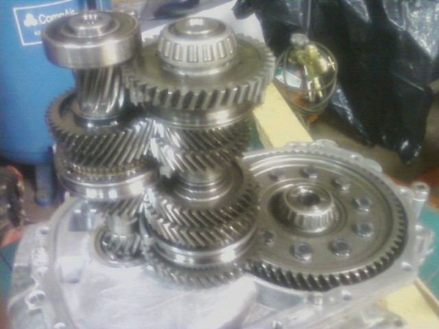

final drive installed.
team m factory 4.00000000000! final drive.
top speed in mph in each gear @9000rpms (factory tire diameter)
1st: 59.14
2nd: 88.71
3rd: 122.15
4th: 167.13
5th: 239.17( which i'll never see!)
