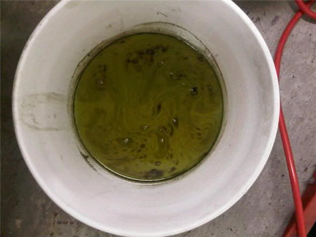

for about 2 months i have been seeing a leak around my head gasket so i searched the forum and people said if there is oil in the coolant u may have a blown head gasket wut do u think?
This is wut came out of radiator.

You are correct!Sorry.

yup, blown headgasket...

wow def looks like a blowen head gasket to me... happened to me in my lightning it was a pita to change should be muchhhhh easier in an evo though

Sure looks like it. To be certain, do a leak down test. Does the car overheat and/or get no heat in the cabin?

i did a leak down it was all good and the heat kicks ***

yeah normally when coolant and oil mix it doesn't retain its green hue. can you post pics of said leak?
