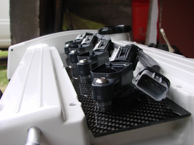

any suggestions on the COP?......this spoolinup kit looks cheap enough for me .....but seriously any suggestions.....I am also just thinking about a ported stock intake manifold and millspec tb instead of the Magnus.....
http://www.szabaga.com/store/files/COP1.jpg

Originally Posted by Teal2nnr
2150 sounds a bit over kill.....unless he was running E85.... 1600's would do for pump, but yes 2150's wouldn't run out of fuel.
Well they might be overkill, but I would rather have too large of injectors than too small. I am just a little biased as I have switched from 660 -> 880 -> 1150 now You never know what you might do in the future.
