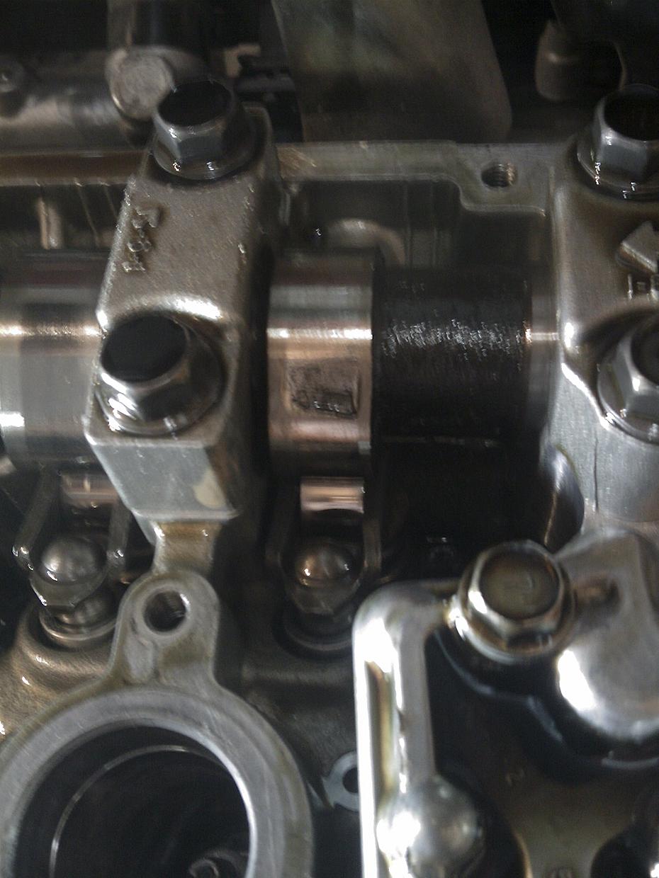

We didn't get the head off cause we got off to a late start last night, and didn't have the "head bolt removal tool" or whatever. Anyway, got the valve cover off, handcranked the engine, and the picture explains itself.
PS, I know I said the leakdown was on the exhaust side. I'm trying to figure out if I missheard or if they misspoke. This was on the intake on number 4. We're going to pull the head tonight.

^How large of a chunk came off the lobe? When you get the head removed I would love to see more pictures. I wonder where that metal is now...

I'm going to hold off on pulling the head for tonight, since I don't have the head bolt removal tool and I hear from a credible source that that chip in the cam is most likely the cause rather than a symptom.
I'm going to save the head and replace the cam to start with.
As for the chip, I don't see a path that it could follow to enter the block (the valve guides are too tight for something that large). It probably made it to the oil pan and got caught up in the filter or still sits in the pan.
I'm going to still replace the spark plugs and see what I can inspect on the cylinder wall while it's off. The shop looked with a camera before though and didn't see a problem (yet they missed the cam?).
We'll see

I think ther was another guy on here that had same problem with gsc272's old version not the s2's i would get together with gsc and try and get a replacment good luck
